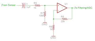

  • Thank you Sima.  My plan was a basic non-inverting op-amp with AC coupled input.  I'm also planning an in-series resistor per Kai's suggestion to ensure current is limited.  Here is the circuit:
  • Thank you Kai.  I will ensure I use a current limiting resistor of at least 10 ohms to ensure our 100mV signal does not produce more than 10mA current.  I plan to use 1k to have plenty of margin which shouldn't be a big deal thanks to the low input current.  Note that the 150V actuation is on a separate transducer so there isn't risk of that voltage appearing.
    I am still thinking the OPA365 doesn't provide any overhead as we are looking for 21x gain at up to 10MHz.  It sounds like your suggestion is 2xOPA365, each with gain around 4.5x (allowing overhead of 45MHz vs 200MHz).  This is okay, although we have mentioned some parts with over 1GHz bandwidth which allows more overhead and solution in one chip.  I'm interested in your thought on OPA858.
  • Hi Jon,
    it heavily depends on your application how much overhead you need. It's a difference whether you just want to detect the begin of an echo or if you want to reproduce the echo with 0.001% distortion Relaxed

  • Hello Jon,
      Were you able to continue with the OPA356? It looks like another advantage with the OPA356 is that it is rail to rail, with the OPA858 you will face clamping at the negative supply of 1.05V with an input signal of 100mV and gain of 20.
