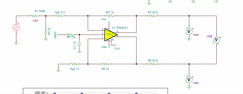

HELLO, my input signal is a not symmetrical signal ,it is a bipolar signal bandwidth is 40M, and it's voltage range is from -50v to 450V(ingore the setting in the tina), now i want to use the circuit below ,using ths4521 to interface to ADC3441.now i scale the input to 1.6vpp 。there is a problem ,the input signal may have high common voltage input about 200V,how should i modify this circuit to Suppresses high common mode voltage
I still want to record the voltage high about 3KV, may be the common mode voltage of this signal will be up to 1kV,how should i do ?Using Op amps with high common mode voltage or others?
