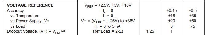

I am trying to interface a loadcell with controller's PLC which can read 0 - 10V or 4- 20mA of analog signal.
I tried to interface loadcell with PLC but got failed. After some searching on web i became to know that INA125P helps to interface loadcel with other devices. So i order sample of INA125P to try.Unfortunately the same result repeats here also.
I used the connection same described in starting of datasheet of INA125P. Used Rg =10k and sleep tied up with VCC.
Used power of 5v which is regulated from 7805.
Loadcell details:
Red - V+ : 5VDC
Black - Gnd : Gnd
Green - Signal +
White - Signal -
Operating Volt : 5vdc
Maximum Load :3kg.
when i checked the signal output using multimeter its showing +2.5v for both signal of loadcell without any load on loadcell and not connected to INA125P. but while connected to INA 125P its showing some mv on meter and it varies each poweron time. but not varying output while applying load on load cell.
why it is like this?
Does i did any mistakes in wiring ?
I am trying to get voltage varying output to interface with PLC analog module. Please help to overcome this issue.
Enclose herewith the schematic diagram of INA125P. Find the diagram for more details.
