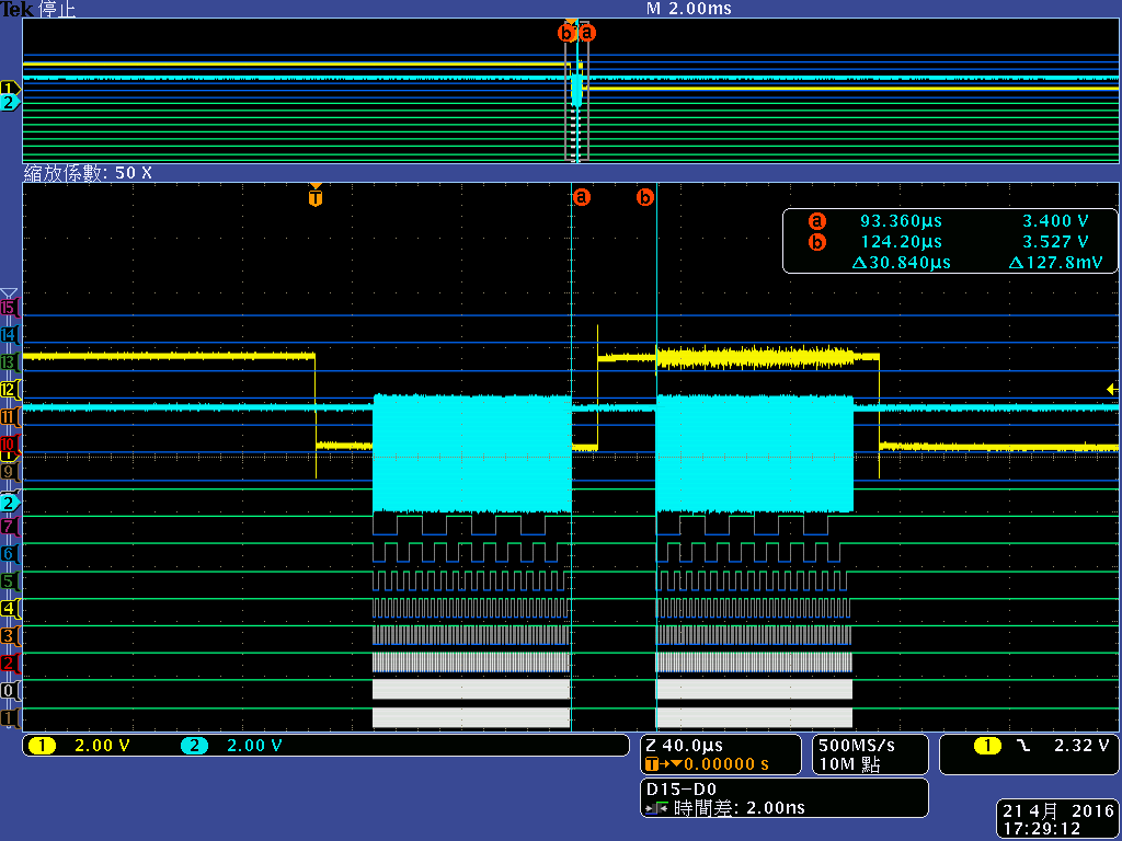

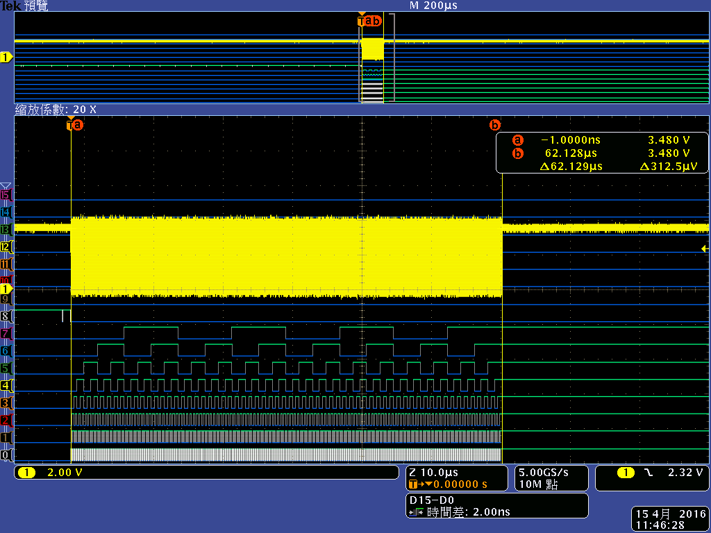

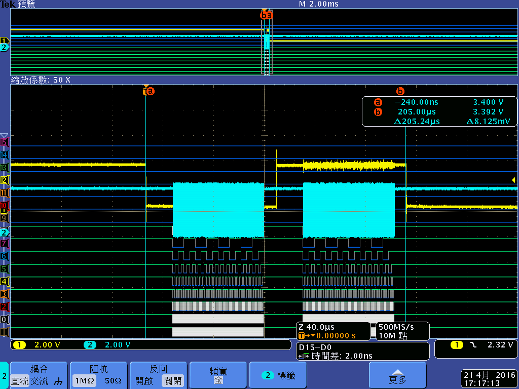

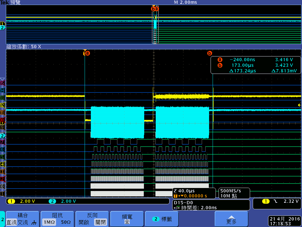

    Timing measurement for access to a CPLD via GPMC, times for write cycle
    SDK 1.1.0.6, CCS  Version: 6.0.1.00040, Spectrum Digital XDS560v2 LC
    XDCtools 3.25.3.72, BIOS 6.35.4.50,
    slow timing (GPMC defaults)
    GPMC_GPMC_CONFIG1_0
    00601200
    GPMC_GPMC_CONFIG2_0
    00101001
    GPMC_GPMC_CONFIG3_0
    22060514
    GPMC_GPMC_CONFIG4_0
    10057016
    GPMC_GPMC_CONFIG5_0
    010F1111
    GPMC_GPMC_CONFIG6_0
    0F070000
    GPMC_GPMC_CONFIG7_0
    00000F41
    gives (150 + 250) ns = 400 ns (2.5 MHz) (Scope ALL 149)
    fast timing (register edit) according to Figure 7-14 SPRUH73K
    GPMC_GPMC_CONFIG1_0
    00601200
    GPMC_GPMC_CONFIG2_0
    00061001
    GPMC_GPMC_CONFIG3_0
    22030512
    GPMC_GPMC_CONFIG4_0
    05047016
    GPMC_GPMC_CONFIG5_0
    010F0711
    GPMC_GPMC_CONFIG6_0
    05040000
    GPMC_GPMC_CONFIG7_0
    00000F41
    gives (50 + 250) ns = 300 ns (3.33 MHz) (Scope ALL 150)
    WRACCESSTIME = 5, otherwise
    CortxA8: Trouble Halting Target CPU: (Error -2062 @ 0x3E418) Unable to halt device. Reset the device, and retry the operation. If error persists, confirm configuration, power-cycle the board, and/or try more reliable JTAG settings (e.g. lower TCLK). (Emulation package 5.1.641.0)
    XDCtools 3.30.5.60, BIOS 6.41.0.26
    slow timing as programmed (GPMC defaults)
    GPMC_GPMC_CONFIG1_0
    00601200
    GPMC_GPMC_CONFIG2_0
    00101001
    GPMC_GPMC_CONFIG3_0
    22060514
    GPMC_GPMC_CONFIG4_0
    10057016
    GPMC_GPMC_CONFIG5_0
    010F1111
    GPMC_GPMC_CONFIG6_0
    0F070000
    GPMC_GPMC_CONFIG7_0
    00000F41
    gives (150 + 20) ns = 170/180 ns (5.55 MHz) (Scope ALL 151)
    GPMC_GPMC_CONFIG1_0
    00601200
    GPMC_GPMC_CONFIG2_0
    00061001
    GPMC_GPMC_CONFIG3_0
    22030512
    GPMC_GPMC_CONFIG4_0
    05047016
    GPMC_GPMC_CONFIG5_0
    010F0711
    GPMC_GPMC_CONFIG6_0
    05040000
    GPMC_GPMC_CONFIG7_0
    00000F41
    gives (50 + 20) ns = 70 ns (14.3 MHz) (Scope ALL 152)
    which is the timing expected

    The code the timing was measured with is
                /* write at address i the data ~i to get A/D toggle on the scope */
                for ( i = 0; i < 256; ++i ) {
                    cpld_register.cpld_register16[i] = ~i;
    (As you can see, there are some more ops as the memory access only.) The use of special assembler instructions ldmia, stmia would require information about interfacing this with C, as I asked in my former posting.

    However, I use oscilloscope to measure and get 62 us likes picture below
    Could you give me some suggestion?
    Marcus

    I used the GPMC /CS, /WR, RD lines to watch my transfers in the scope (with higher time resolution).
    Your screenshot shows a 2048 byte transfer in 62 microseconds (as 1024 words in some 60 ns each)?
    I have no idea where the extra time comes from you compute (using a 24 MHz GMTIMER?). I think less than 10
    additional microseconds for initiating the transfer, interrupt handling etc. are accepable.

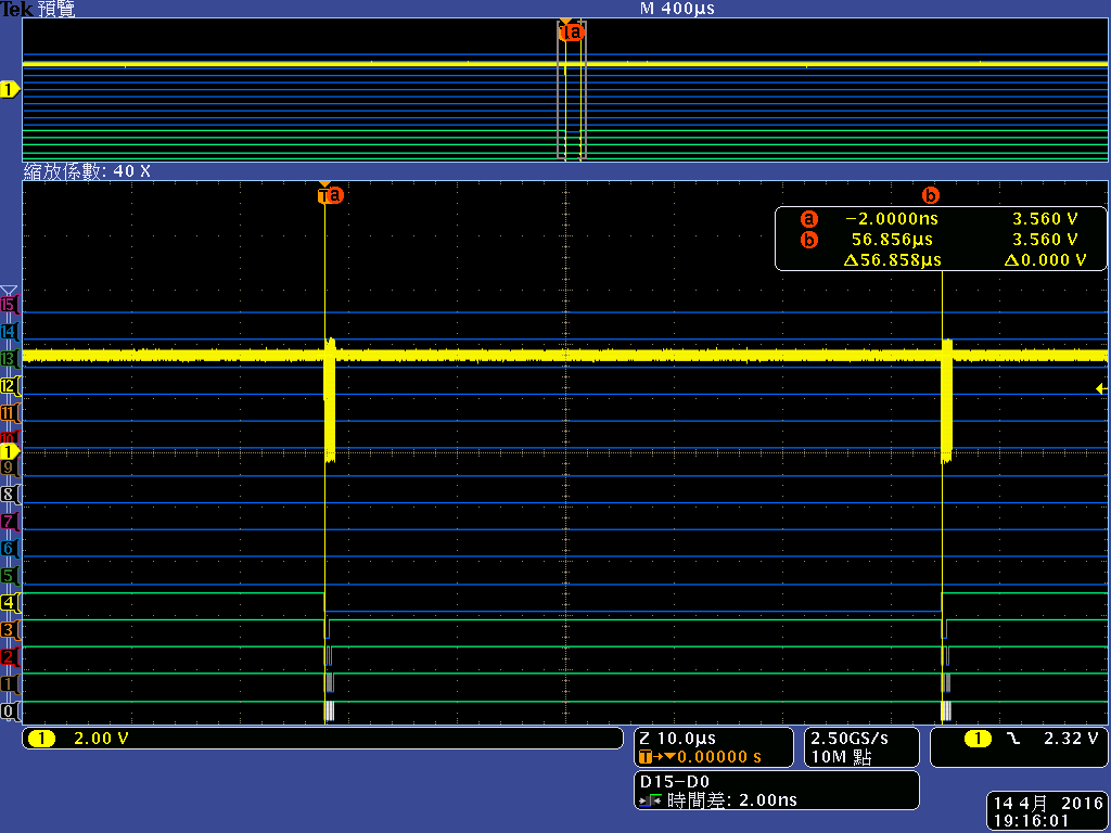

  • Hi Frank :
    I appreciate your reply.
    I agree that additional microseconds for initiating the transfer, interrupt handling etc. are acceptable.
    But in my case the time two EDMA take are too long and picture below shows that.
    As you can see that two EDMA take about 56 us, is it normal?
    I have modified the code and make them as simple as they can, but not help enough.

  • Hi Marcus,
    I think 56 microseconds are a (too) long time between the two EDMA transfers.
    From my distant point of view I cannot see where the time gets lost, sorry.
    Maybe you can add some more timer measurements in your code (like in your posting before).

    main loop : Yellow line stands for gpio and blue line stands for CS, the total time between two EDMA is about 173 us.
    The time between two EDMA is about 15 us
    Task loop: Yellow line stands for gpio and blue line stands for CS, the total time between two EDMA is about 205 us.
    The time between two EDMA is about 30 us
    I do not know why the same statements take different time in two different loop, maybe it is normal using sysbios.
