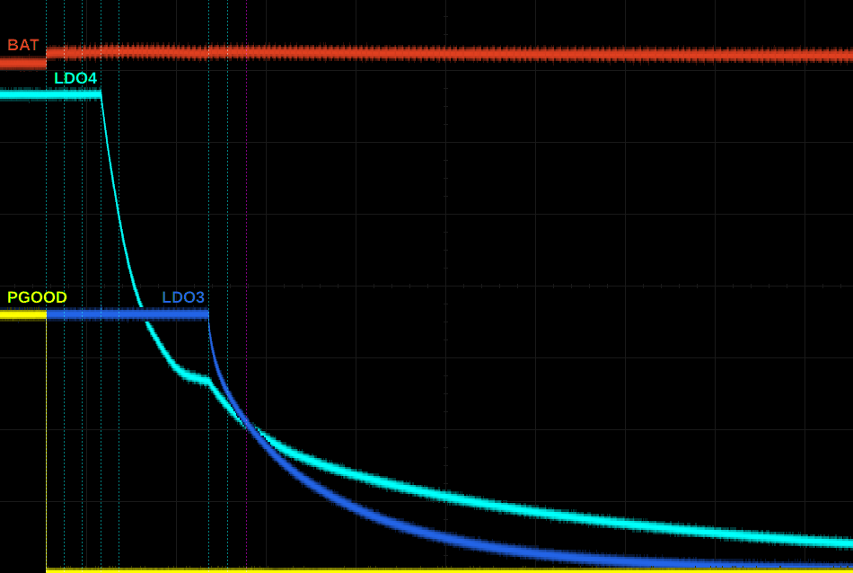

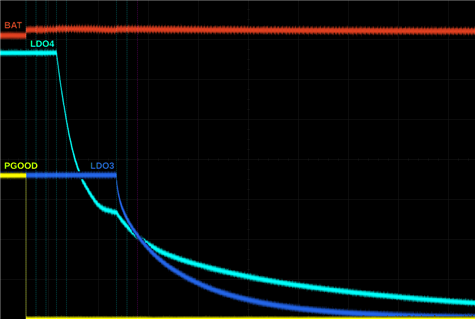

I've been investigating power management on the BBB in detail (mostly in relation to its 3v3b-regulator bug), and along the way noticed that during shutdown the 3v3 rail (LDO4) leveled off at around 1.3V until LDO1 shuts off at strobe 15, after which it would finally start to drop to zero.
This shows various PMIC terminals on a BBB (patched to fix the 3v3b-issue) during an ACTIVE-to-OFF transition (while powered through BAT using a variable PSU at 3.6V):
Note the supply rail dip once the 1.8V rails begin to leak to the 3.3V rail, and the sudden jump upward at strobe 15 indicating significant current was flowing through LDO1 at the time it was shut off. In fact, if a transition into SLEEP-state is done, the 3.3V rail remains at 1.3V indefinitely and the BAT current measured in this state was quite significant (iirc ~ 45 mA).

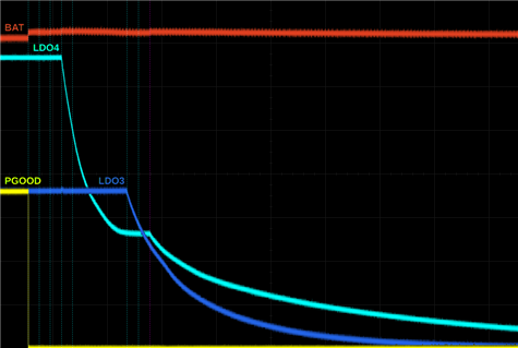

As experiment, VDDS was reconnected to LDO3 instead of LDO1 (by moving resistor R8 to R9). I did not notice any difference during powerup, but shutdown changed significantly:
Leakage evidently still occurs, but the duration of this situation appears substantially reduced. Transition to SLEEP-state (RTC-only sleep) in this case works normally, and produces essentially the same plot as the transition to OFF-state depicted above (since LDO1 wasn't included in these measurements).

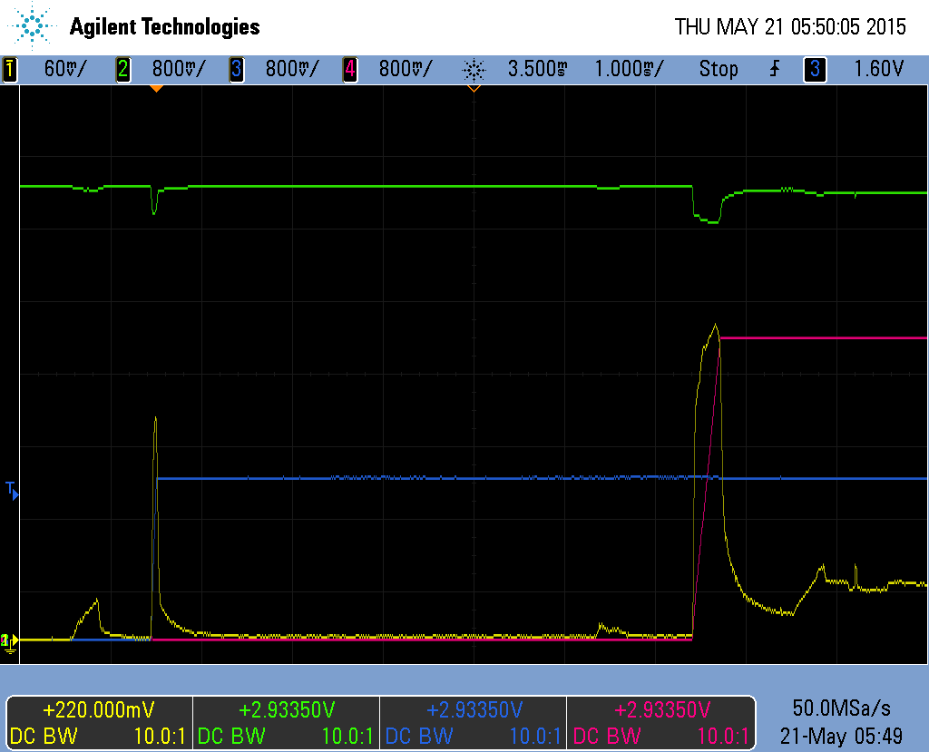

    For the first point, here's a close-up of power-on sequencing (strobes 1-5):
    The region of interest is on the left between strobes 1 and 2, since this is the 1ms window in which the official power sequencing is being violated. However, after DCDC1 has charged up VDDS_DDR, current falls back towards negligible. In particular, apparently no undesirable current flows as a result of this. Of course it's still possible there might be a problem with voltage-induced stress, although typically there would be protection diodes guarding against this (hence current flow would be visible).

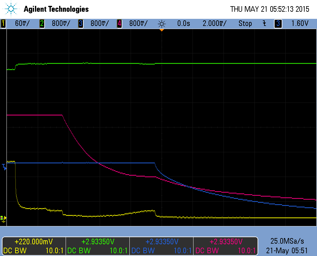

    For the second point, here is a close-up of entry into SLEEP-state:
    Note that current consumption initially drops to negligible once the 3.3V supplies are cut, but when they drop significantly below the 1.8V supplies current increases again and the 3.3V supplies are prevented from falling much lower. Once the 1.8V supplies are cut, the current stops and both supplies begin to drop towards zero. This is clear evidence of heavy leakage occuring from the 1.8V supplies to the 3.3V supplies. When entering OFF-state the same thing is visible, except current consumption needs to be read from the falling slope of SYS since the power path is already disabled at strobe 7.
    As explained in my original post, if VDDS is moved to LDO1, this situation persists until strobe 15 (hence indefinitely if one enters SLEEP-state). This clearly shows that the current flows via VDDS. Since the function of VDDS is still unclear, I do not know which path(s) this current might be taking, but normally I would expect such heavy current flow between separate power supply rails to be undesirable. In this case the current appears to be about 35 mA, but it will depend on how much current is drawn from the 3.3V supplies and I've seen worse (i.e. closer to the max rating of VDDS).
