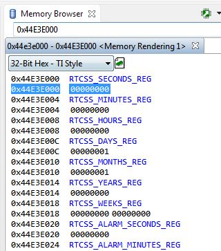

currently, i am unable to see the RTC registers or the LCDC registers. when i look at the registers in the "registers" window i get an error, when i look at them in the memory browser i get "???????" instead of values. when i try to enable the RTCSS module the code hangs waiting for:

  • alright so if i change nothing i should be able to at least view the RTC registers, even without running your extra script? because when i run our GEL file, as is, i get all ????????'s for all values.
    does this imply we have something wrong with the way our JTAG is setup/routed/layed out?
  • What if you open up a memory window somewhere other than the RTC?  Try 0x40300000.  That's internal memory.  If you can read/modify/write that area, then i don't think there is anything wrong with your JTAG.

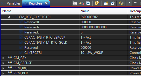

    As for RTC, if you are still getting ????, you might have an issue with the functional clock.  What the value at 0x44e00804 (RTC_CLKSTCTRL)?  That will indicate if the RTC clock is active.

  • most other memory locations are fine. there are a lot of modules that i can activate and use, the only other exception that i have found is the LCDC module which also has a lot of ?????? in the memory window even after turning on the module
    i will check that register again and make sure it is active (but the fact that you were able to see the registers using just the GEL file implies i should too)
    i will double check the power connections
  • checking the register shows everything is active
  • it looks like our RTC circuit is getting the correct voltage but our RTC_PWRONRSTn is connected to a 3.3V supply and is at 2.60V and it looks like it's supposed to be 1.8V max. likely that is our problem. in addition, that 3.3V supply which is likely being brought down by connecting it to the 1.8V tolerant pin and is at 2.6V is also the supply to other things on the board so that might explain why i am having difficulties in other areas. looks like a board rev for us
    thanks for your help. hard to believe we overlooked this.
