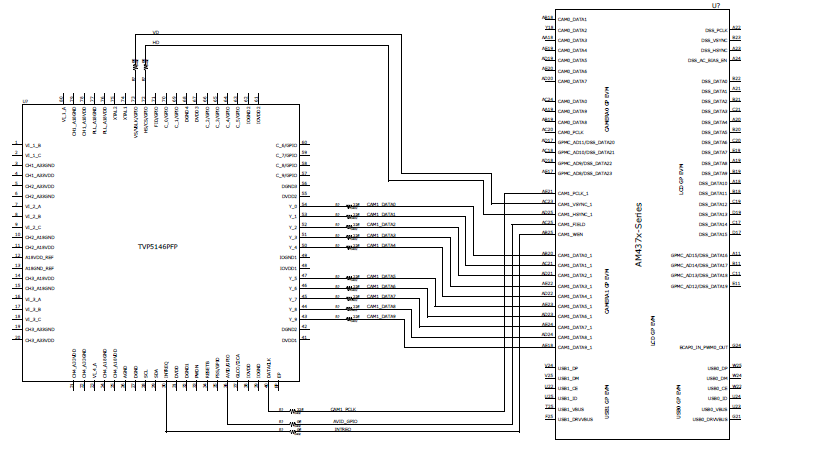

We have a custom board with AM4378 connected to TVP5146. The schematic is attached.
After making changes to the device tree and enabling support for tvp5146 in the kernel, it is detected as a device on the i2c bus. However, no /dev/video entry appears. More importantly, "VPFE: Invalid Bus Width error -22" is shown during bootup. What could be the problem, and how do I solve it?
The relevant parts of the device tree are:

&i2c0 {
tvp514x@5c {
   compatible = "ti,tvp5146m2";
   reg = <0x5c>;
   status = "okay";
   port {
    tvp514x_0: endpoint {
     remote-endpoint = <&vpfe1_ep>;
&vpfe1 {
  status = "okay";
     pinctrl-names = "default";
     pinctrl-0 = <&cam1_pins_default>;
 port {
  vpfe1_ep: endpoint {
   slave-mode;
   remote-endpoint = <&tvp514x_0>;
   ti,am437x-vpfe-interface = <2>;  //10 bit BT656
           hsync-active = <1>;
   vsync-active = <1>;
   pclk-sample = <0>;
