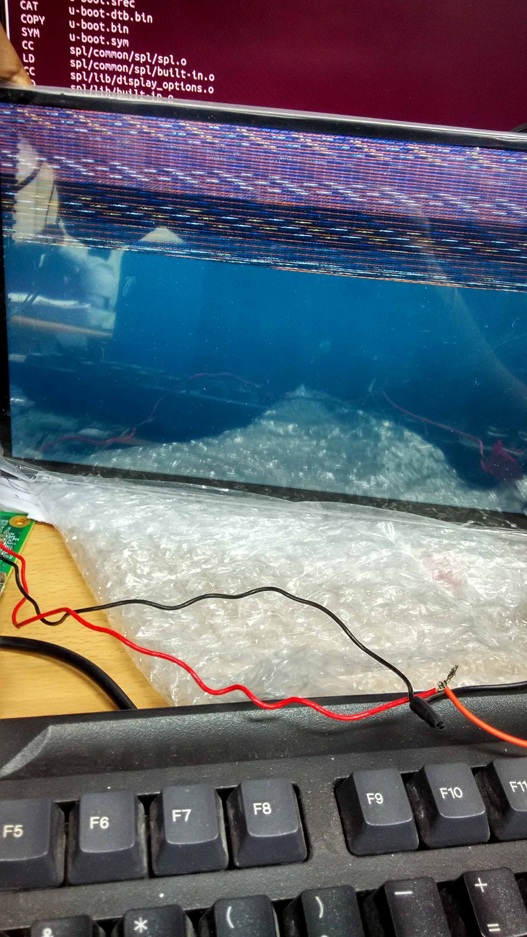

  •  hi kemal using bmptotaster tool i generated new image file for 1280x800 resolution,
    but using this file, u-boot is not booting, so i copied starting 30,000 line from image.h file
    now its displaying like below, please let me know if anything need to modify.

  • it was fixed by setting clock in SetUpLCD() function in rasterDisplay.c
    /* Configure the pclk */
    //RasterClkConfig(SOC_LCDC_0_REGS, 71100000, 192000000);
    RasterClkConfig(SOC_LCDC_0_REGS, 40000000, 192000000);
    thanks Kemal for your great support.
