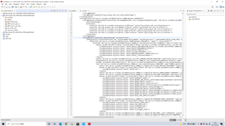

I tried to create a new project on CCS and associate files with it, but I can't find the soc.h file and can't proceed.

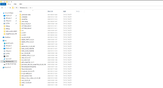

    I worked on creating a project based on your reply. First of all, just to confirm, do I need to create the "BenchmarkProjects" folder beforehand? (I tried creating it beforehand and then running it, but it failed)
    As far as I can tell from the error message, that's not the problem.(screenshot)
    "指定されたファイルが見つかりません" => "The specified file cannot be found"
    ”指定されたパスが見つかりません” => "The specified path cannot be found"
    I think I'm passing the ball, but I'm told that I'm not. It would be helpful if you could tell me about that too.

  • Hi Kota,
    When you ran BenchmarkProjectCreate.bat, the PDK directory path had a special character ¥. That may be the reason. Please see the log below when I created the projects:

  • Kihara-san,
    regarding this gmake error:
    gmake: *** No rule to make target 'C:/ti/processor_sdk_rtos_omapl138_6_03_00_106/demos/audio-benchmark-starterkit/src/singlePrecision_FIR/DSPF_sp_fir_cplx_d.c', needed by 'DSPF_sp_fir_cplx_d.obj'.
    This error usually occurs when either the source file is not found in the expected location, or the project does not have the correct location to it.
    Can you share the three .*project files (.project, .cproject, .ccsproject) inside the project folder?
    Thank you

  • Kihara-san,
    Thank you for the project. I imported into CCS 10.1. and I do not have any issues compiling the DSPF_sp_fir_cplx_d.c source file along with the other two:
    **** Clean-only build of configuration Debug for project Benchmark_FIR_lcdkC6748_c674ExampleProject ****
    "C:\\ti\\ccs1011\\ccs\\utils\\bin\\gmake" -k -j 8 clean -O
    DEL /F "Benchmark_FIR_lcdkC6748_c674ExampleProject.hex" "Benchmark_FIR_lcdkC6748_c674ExampleProject.out"
    DEL /F "Benchmark_log.obj" "DSPF_sp_fir_cplx_d.obj" "DSPF_sp_fir_cplx_opt.obj"
    DEL /F "Benchmark_log.d" "DSPF_sp_fir_cplx_d.d" "DSPF_sp_fir_cplx_opt.d"
    DEL /F "Benchmark_log.asm" "DSPF_sp_fir_cplx_d.asm" "DSPF_sp_fir_cplx_opt.asm"

    Can you provide a screenshot of the project expanded in the project view? Something like:
    Thank you
  • Hi, Ki
    I take screan shot and send you. Please check it.
    Sincerely, Ki
    Kota
  • Thank you. I can clearly see that the link to DSPF_sp_fir_cplx_d.c is broken
    If you right-click on the file and select "Properties" in the context menu, a Properties dialog for the file should open. Please provide a screenshot of the" Resource" information like below
  • Hi Ki
    I see.
    I send you my screenshot. Please check it.
    Sincerely, Ki
    Kota
  • Hi Kota,
    From your screen capture, you can see that the Resolved location for file DSPF_sp_fir_cplx_d.c doesn't exist. That's the root cause of your problem.
    Jianzhong
  • Hi Jianzhong,
    I see. I check this location and check that DSPF_sp_fir_cplx_d.c file name changed DSPF_sp_fir_cplx_d 1.c.
    So I rewrote file name to "DSPF_sp_fir_cplx_d.c".
