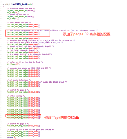

when power on and off, there is pop noise in Class D. The output filter now is 1uH+0.1uF.
TLV320AIC3007: TLV320AIC3007 After turning on the power of the Class-D speaker that causes pop noise
