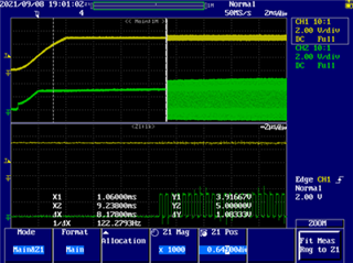

[POWER-ON RESET]
it is difficult to follow figure 24. internal power-on reset timing especially "the system clock must be supplied as soon as power is applied; more specifically, the device must receive at least three system clock cycles before VDD > 4 V. While VCC/VDD < 4 V (typical)".
Customer power up sequence is below.
wait approx. 7ms after 5V supplies then system clock supplies.
Question here is
#1: Are there any concern about this power up sequence?
#2: In below power up sequence with I2S mode, when should we set FMT to "H"?  after 1024 system clocks from first edge?
