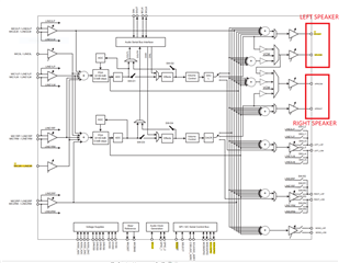

We are using TLV320AIC31106 codec for our project. As per the project we had connected two speakers in left channel connected one speaker and right other one.
As per our project we need shift one speaker to another as per the situation (Phone application Handset and Handsfree), I had tried to mute the  LFET and Right DAC channel in the  Table 51. Page 0 / Register 43: Left DAC Digital Volume Control Register on fly.
Read the register it is applying the values are not, its updated but not muted. So please provide your inputs to switch from one channel to other without disturbing the audio.
Please find the configuration details and diagram.

    Is this TLV320AIC1106 or TLV320AIC3106? The title is for AIC1106, but the diagram is for AIC3106.
    For AIC3106, are you sending your input from MIC3R/LINE3R only and enabling the left ADC path to HPL output and right ADC path to HPR output?
    Can you use the diagram above and highlight the path you want to change on the fly so it's clear?
    Basically if the path is direct as I mentioned above, you should be able to control the volume directly for example page 0 register 43 for the DAC volume and output stage volume per table 53 to each output stage and the output stage has its own gain/control like HPL in page 0 register 51 which you can mute as well.
    You can start muting say HPL using page 0 register 51 bit D3 first and then continue from there.

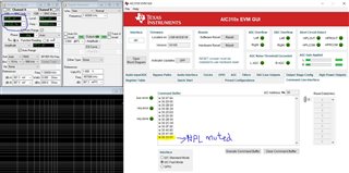

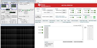

  • HI,

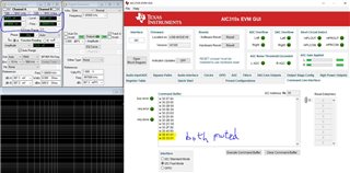

    See attached files which I used to check this functionality.
    I just used the DAC path from AP-PSIA to HP output since the digital audio interface will come from your MCU anyway.
    As you can see I just set the HPR /HPL to mute and the amplitude disappears in the AP analog analyzer.
    The register setting is also shown in the file.
    Below is the high level diagram showing the path with its respective register which I think can help you configure the path you desire.
    5468.TLV320AIC3106_Functional_block_Diagram_With_Registers.pdf
    Regards.

    delay();
    void mic_selection (void)
    /* Declaration of codec write variables */
    uint16_t reg_param_mic[2] = {0};
    /* Declaration codec read variable for MIC*/
    uint8_t mic_reg ;
    /* Assigning LEFT DAC Digital Volume Control Register address.*/
    reg_param_mic [0] = configparam_tlv[AIC3106_REG0_MICBIAS].add;
    /** Sending the Codec LEFT Volume Setup Register address for read
    * the register value.
    i2c_read_reg (CODEC_ADDRESS,&reg_param_mic,&mic_reg,1);
    /* Providing some delay for the register write or read to codec. */
    delay();
    /* Clearing the volume as per the MUTE basis */
    mic_reg = (mic_reg) & (~MIC_DISABLE );
    /* Assigning The LEFT DAC channel for mute condition.*/
    configparam_tlv[AIC3106_REG0_MICBIAS].data = mic_reg |MIC_DISABLE;
    /* Assigning register data value to codec varaible. */
    reg_param_mic [1] = (configparam_tlv[AIC3106_REG0_MICBIAS].data);
    /* Sending register address and data using I2C to codectlv320.*/
    i2c_write_reg (CODEC_ADDRESS,&reg_param_mic,2);
    delay();
    Please let me know any changes I need to do.
    There's no particular sequence to mute/unmute HP output.
    Attached here is the settings I used to enable MIC3L/R to HPL/R output. In my testing I sent the digital input data from MIC3 back to digital output and I just mute/unmute the respective block.
    test on EVM.pdf
    # Device Address, Register Address, Data (all in hex)
    w 30 11 0F
    w 30 12 F0
    w 30 16 7C
    w 30 13 7C
    w 30 0F 00
    w 30 10 00
    w 30 19 80
    w 30 07 8A
    w 30 29 02
    w 30 2B 00
    w 30 0E C0
    w 30 25 E0
    w 30 26 10
    w 30 2F 80
    w 30 40 80
    w 30 41 0D
    w 30 33 0D
    Peter
  • Dear Team,
    It seems register address are different, please use the attached manual for register address and let me know the exact setting using some sample code.
    tlv320aic3106.pdf
    As mentioned in the comment above, the values are in hex where else the register address in datasheet is in decimal. They are the same register address.
    Something in your system prevents the muting/unmuting.
    Peter
