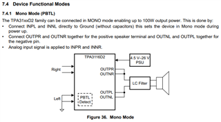

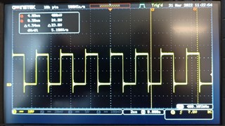

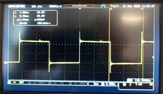

I am using two amplifiers in Master/Slave mode, designed following the datasheet.
In idle the amplifiers get hot very soon. What the problem could be? I use a 10uH inductor (74477010).
The PWM frequency before the LC filter is the half of the master one. Is that normal?
