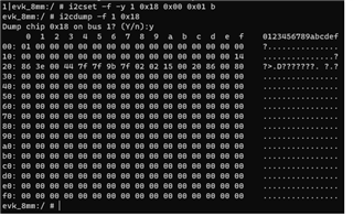

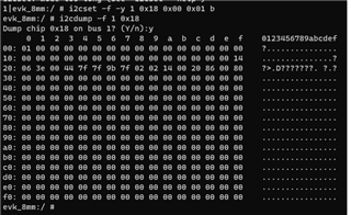

    I2Cdump without playing audio:
    PAGE 0-
    Page 0 -

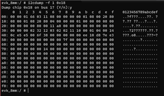

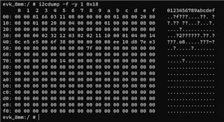

    While playing audio:
    Page 0 -
    page 1 -
    Measured clocks : MCLK = 12.28 MHz, BCLK = 1.536  MHz, WCLK = 47.99 KHz
