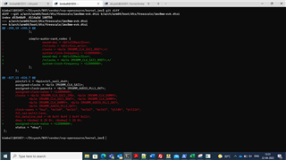

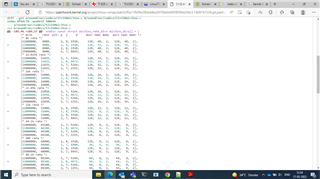

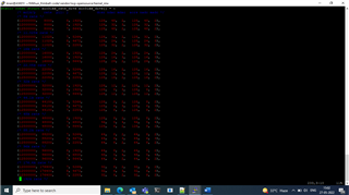

  • Hi Team,
    Somewhere I can see few clock related changes in driver file.
    Could you please check clock related changes:
    After registering codec, Do we need to write few registers manually to enable DAC settings? Or it will be done by codec driver?
    Like if you check previous comments,  pdjuandi suggested few points to enable DAC and asked to change few registers , will it not done by driver file?
    Divyesh

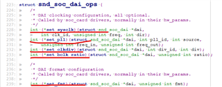

  • Your dts file will configure the soundcard accordingly including the clock and input/output module, you will need to consult the host vendor on how to interface with the soundcard driver.
  • Following api can help to set the sample rate and related clk.
  • Hi Shengjao and pdjaundi,
    Please review kernel changes and let me know if any additional changes required
    Main Node:
     sound-tlv320aic31xx {
                    compatible = "simple-audio-card";
                    simple-audio-card,name = "tlv320aic31xx-Codec";
                    simple-audio-card,format = "i2s";
                    simple-audio-card,frame-master = <&cpudai2>;
                    simple-audio-card,bitclock-master = <&cpudai2>;
                    simple-audio-card,widgets =
                            "Speaker", "SpeakerOUT";
                    simple-audio-card,routing =
                            "SpeakerOUT", "SPK";
                    cpudai2: simple-audio-card,cpu {
                            sound-dai = <&sai1>;
                    simple-audio-card,codec {
                            system-clock-frequency = <12000000>;
                            /*clocks = <&clk IMX8MM_CLK_SAI1_ROOT>;*/
            reg_3p3v: regulator-3p3v {

  • Hi Team
    please find latest logs and changes
    please review and let me know if i missed anything.
    dmesg_int_codec_23_05.loglogcat_int_codec_23_05.log
    diff --git a/arch/arm64/boot/dts/freescale/imx8mm-evk.dtsi b/arch/arm64/boot/dts/freescale/imx8mm-evk.dtsi

  • Hi Shen,
    Need your help to add these freq in below driver file :
    49.152M, 24.576M, 12.228MHz etc.
    static const struct aic31xx_rate_divs aic31xx_divs[] = {
    /* mclk/p rate pll: j d dosr ndac mdac aors nadc madc */
    /* 8k rate */
    {12000000, 8000, 8, 1920, 128, 48, 2, 128, 48, 2},
    {12000000, 8000, 8, 1920, 128, 32, 3, 128, 32, 3},
    {12500000, 8000, 7, 8643, 128, 48, 2, 128, 48, 2},
    /* 11.025k rate */
    {12000000, 11025, 7, 5264, 128, 32, 2, 128, 32, 2},
    {12000000, 11025, 8, 4672, 128, 24, 3, 128, 24, 3},
    {12500000, 11025, 7, 2253, 128, 32, 2, 128, 32, 2},
    /* 16k rate */
    {12000000, 16000, 8, 1920, 128, 24, 2, 128, 24, 2},
    {12000000, 16000, 8, 1920, 128, 16, 3, 128, 16, 3},
    {12500000, 16000, 7, 8643, 128, 24, 2, 128, 24, 2},
    /* 22.05k rate */
    {12000000, 22050, 7, 5264, 128, 16, 2, 128, 16, 2},
    {12000000, 22050, 8, 4672, 128, 12, 3, 128, 12, 3},
    {12500000, 22050, 7, 2253, 128, 16, 2, 128, 16, 2},
    /* 32k rate */
    {12000000, 32000, 8, 1920, 128, 12, 2, 128, 12, 2},
    {12000000, 32000, 8, 1920, 128, 8, 3, 128, 8, 3},
    {12500000, 32000, 7, 8643, 128, 12, 2, 128, 12, 2},
    /* 44.1k rate */
    {12000000, 44100, 7, 5264, 128, 8, 2, 128, 8, 2},
    {12000000, 44100, 8, 4672, 128, 6, 3, 128, 6, 3},
    {12500000, 44100, 7, 2253, 128, 8, 2, 128, 8, 2},
    /* 48k rate */
    {12000000, 48000, 8, 1920, 128, 8, 2, 128, 8, 2},
    {12000000, 48000, 7, 6800, 96, 5, 4, 96, 5, 4},
    {12500000, 48000, 7, 8643, 128, 8, 2, 128, 8, 2},
    Please help to add mentioned freq in above array. Please calculation required for other parameter.
    because we are using mentioned freq  and imx cannot divide any value.
    if I configure it to 12000000, the soundcard cannot work.
    The mclk cannot be divided to any value, typical values are 49.152M, 24.576M, 12.228MHz etc.
    thanks
  • In aic31xx_set_dai_sysclk, tell me the value of clk_id, freq and aic31xx->p_div. Thanks
  • Hi Shen,
    freq = 12288000
    clk_id = 0
    p_div = maybe 1 I guess (not sure).
  • The value of aic31xx->p_div is very important for the table setting.
    As you know the first column of aic31xx_divs is MCLK/aic31xx->p_div, help me to check this. Thanks.
  • where to check this value?
    please refer it  p_div =  1

  • diff --git a/arch/arm64/boot/dts/freescale/imx8mm-evk.dtsi b/arch/arm64/boot/dts/freescale/imx8mm-evk.dtsi
    index 592d373..f22f02b 100755
    --- a/arch/arm64/boot/dts/freescale/imx8mm-evk.dtsi
    +++ b/arch/arm64/boot/dts/freescale/imx8mm-evk.dtsi
    @@ -8,6 +8,7 @@
     #include <dt-bindings/usb/pd.h>
     #include "imx8mm.dtsi"
     #include "imx8mm-nfc.dtsi"
    +#include <dt-bindings/sound/tlv320aic31xx-micbias.h>
     	firmware {
    @@ -137,6 +138,7 @@
     	bt_sco_codec: bt_sco_codec {
     		#sound-dai-cells = <1>;
     		compatible = "linux,bt-sco";
    +		status = "disabled";
     	sound-bt-sco {
    @@ -232,6 +234,52 @@
     		cpu-dai = <&micfil>;
    +       tlv31xx_mclk: oscillator {
    +               compatible = "fixed-clock";
    +               #clock-cells = <0>;
    +               clock-frequency = <12000000>;
    +               clock-output-names = "tlv31xx-mclk";
    +       sound-tlv320aic31xx {
    +               compatible = "simple-audio-card";
    +               simple-audio-card,name = "tlv320aic31xx-Codec";
    +               simple-audio-card,format = "i2s";
    +               simple-audio-card,frame-master = <&cpudai2>;
    +               simple-audio-card,bitclock-master = <&cpudai2>;
    +               simple-audio-card,widgets =
    +                       "Speaker", "Speaker Jack";
    +               simple-audio-card,routing =
    +                       "Speaker Jack", "SPK";
    +               cpudai2: simple-audio-card,cpu {
    +                       sound-dai = <&sai1>;
    +               simple-audio-card,codec {
    +                       sound-dai = <&tlv320aic31xx>;
    +                       /*clocks = <&tlv31xx_mclk>;
    +                       clocks = <&clk IMX8MM_CLK_SAI1_ROOT>;*/
    +                       system-clock-frequency = <12288000>;
    +        reg_3p3v: regulator-3p3v {
    +                compatible = "regulator-fixed";
    +                regulator-name = "3P3V";
    +                regulator-min-microvolt = <3300000>;
    +                regulator-max-microvolt = <3300000>;
    +               startup-delay-us = <300000>;
    +                regulator-always-on;
    +        reg_1p8v: regulator-1p8v {
    +                regulator-name = "1P8V";
    +                regulator-min-microvolt = <1800000>;
    +                regulator-max-microvolt = <1800000>;
     	gpio-reset {
     		compatible = "linux,gpios-reset";
     		MCUreset: MCU {
    @@ -604,6 +652,21 @@
     			self-powered;
    +        tlv320aic31xx: codec@18 {
    +                compatible = "ti,tlv320aic3100";
    +                reg = <0x18>;
    +                pinctrl-0 = <&pinctrl_audio_reset_31xx>;
    +                reset-gpios = <&gpio4 1 GPIO_ACTIVE_LOW>;
    +                #sound-dai-cells = <0>;
    +                ai31xx-micbias-vg = <MICBIAS_2_0V>;
    +                HPVDD-supply = <&reg_3p3v>;
    +                SPRVDD-supply = <&reg_3p3v>;
    +                SPLVDD-supply = <&reg_3p3v>;
    +                AVDD-supply = <&reg_3p3v>;
    +                IOVDD-supply = <&reg_3p3v>;
    +                DVDD-supply = <&reg_1p8v>;
     &i2c3 {
    @@ -641,6 +704,7 @@
     		reg = <0x10>;
     		AVDD-supply = <&reg_audio_board>;
     		DVDD-supply = <&reg_audio_board>;
     	ak4458_2: ak4458@12 {
    @@ -648,6 +712,7 @@
     		reg = <0x12>;
     	ak5558: ak5558@13 {
    @@ -656,6 +721,7 @@
     		reset-gpios = <&pca6416 3 GPIO_ACTIVE_LOW>;
     	ak4497: ak4497@11 {
    @@ -665,6 +731,7 @@
     		dsd-path = <1>;
     	ov5640_mipi: ov5640_mipi@3c {
    @@ -688,6 +755,7 @@
     &i2c4{
    @@ -777,7 +845,6 @@
     			csis-clk-settle = <2>;
     			csis-wclk;
     		csi1_mipi_ep: endpoint@2 {
     			remote-endpoint = <&csi1_ep>;
    @@ -854,14 +921,25 @@
     	assigned-clock-rates = <24576000>;
     	status = "okay";
    +&sai1 {
    +        pinctrl-names = "default";
    +        pinctrl-0 = <&pinctrl_sai1>;
    +        fsl,sai-mclk-direction-output;
    +        assigned-clocks = <&clk IMX8MM_CLK_SAI1>;
    +        assigned-clock-parents = <&clk IMX8MM_AUDIO_PLL1_OUT>;
    +        assigned-clock-rates = <12500000>;
    +        status = "okay";
     &sai1 {
     	pinctrl-names = "default", "dsd";
     	pinctrl-1 = <&pinctrl_sai1_dsd>;
    -	assigned-clock-rates = <49152000>;
    +	assigned-clock-rates = <12288000>;
     	clocks = <&clk IMX8MM_CLK_SAI1_IPG>, <&clk IMX8MM_CLK_DUMMY>,
     		<&clk IMX8MM_CLK_SAI1_ROOT>, <&clk IMX8MM_CLK_DUMMY>,
     		<&clk IMX8MM_CLK_DUMMY>, <&clk IMX8MM_AUDIO_PLL1_OUT>,
    @@ -1177,37 +1255,35 @@
    +       pinctrl_audio_reset: pinctrl_audio_reset {
    +               fsl,pins = <
    +                       MX8MM_IOMUXC_SAI3_RXFS_GPIO4_IO28         0x16
    +       pinctrl_audio_reset_31xx: pinctrl_audio_reset_31xx {
    +               fsl,pins = <
    +                       MX8MM_IOMUXC_SAI1_RXC_GPIO4_IO1         0x16
     	pinctrl_sai1: sai1grp {
     		fsl,pins = <
    -			MX8MM_IOMUXC_SAI1_MCLK_SAI1_MCLK	0xd6
    -			MX8MM_IOMUXC_SAI1_TXFS_SAI1_TX_SYNC	0xd6
    -			MX8MM_IOMUXC_SAI1_RXD7_SAI1_TX_SYNC	0xd6
    -			MX8MM_IOMUXC_SAI1_TXC_SAI1_TX_BCLK	0xd6
    -			MX8MM_IOMUXC_SAI1_TXD0_SAI1_TX_DATA0	0xd6
    -			MX8MM_IOMUXC_SAI1_TXD1_SAI1_TX_DATA1	0xd6
    -			MX8MM_IOMUXC_SAI1_TXD2_SAI1_TX_DATA2	0xd6
    -			MX8MM_IOMUXC_SAI1_TXD3_SAI1_TX_DATA3	0xd6
    -			MX8MM_IOMUXC_SAI1_TXD4_SAI1_TX_DATA4	0xd6
    -			MX8MM_IOMUXC_SAI1_TXD5_SAI1_TX_DATA5	0xd6
    -			MX8MM_IOMUXC_SAI1_TXD6_SAI1_TX_DATA6	0xd6
    -			MX8MM_IOMUXC_SAI1_TXD7_SAI1_TX_DATA7	0xd6
    +			MX8MM_IOMUXC_SAI1_MCLK_SAI1_MCLK	0xd6 /*MCLK*/
    +			MX8MM_IOMUXC_SAI1_TXFS_SAI1_TX_SYNC	0xd6 /*WCLK*/
    +			MX8MM_IOMUXC_SAI1_TXC_SAI1_TX_BCLK	0xd6 /*BCLK*/
    +			MX8MM_IOMUXC_SAI1_TXD0_SAI1_TX_DATA0	0xd6 /*DIN*/
    +			MX8MM_IOMUXC_SAI1_RXD0_SAI1_RX_DATA0    0xd6 /*DOUT*/
     	pinctrl_sai1_dsd: sai1grp_dsd {
     		fsl,pins = <
    -			MX8MM_IOMUXC_SAI1_RXD7_SAI1_TX_DATA4	0xd6
    @@ -1222,10 +1298,11 @@
     	pinctrl_sai3: sai3grp {
     		fsl,pins = <
    -			MX8MM_IOMUXC_SAI3_TXFS_SAI3_TX_SYNC     0xd6
    -			MX8MM_IOMUXC_SAI3_TXC_SAI3_TX_BCLK      0xd6
    -			MX8MM_IOMUXC_SAI3_MCLK_SAI3_MCLK        0xd6
    -			MX8MM_IOMUXC_SAI3_TXD_SAI3_TX_DATA0     0xd6
    +			MX8MM_IOMUXC_SAI3_TXFS_SAI3_TX_SYNC     0xd6 /*WCLK*/
    +			MX8MM_IOMUXC_SAI3_TXC_SAI3_TX_BCLK      0xd6 /*BCLK*/
    +			MX8MM_IOMUXC_SAI3_MCLK_SAI3_MCLK        0xd6 /*MCLK*/
    +			MX8MM_IOMUXC_SAI3_TXD_SAI3_TX_DATA0     0xd6 /*DIN*/
    +			MX8MM_IOMUXC_SAI3_RXD_SAI3_RX_DATA0     0xd6 /*DOUT*/
    diff --git a/arch/arm64/configs/imx_v8_android_defconfig b/arch/arm64/configs/imx_v8_android_defconfig
    index a4771d2..edcbaf0 100644
    --- a/arch/arm64/configs/imx_v8_android_defconfig
    +++ b/arch/arm64/configs/imx_v8_android_defconfig
    @@ -574,6 +574,8 @@ CONFIG_THERMAL_WRITABLE_TRIPS=y
     CONFIG_THERMAL_GOV_POWER_ALLOCATOR=y
     CONFIG_CPU_THERMAL=y
     CONFIG_THERMAL_EMULATION=y
    +CONFIG_SND_SOC_TLV320AIC31XX=y
    +CONFIG_SND_SOC_TLV320AIC3X=y
     CONFIG_IMX_SC_THERMAL=y
     CONFIG_IMX8MM_THERMAL=y
     CONFIG_DEVICE_THERMAL=y
    @@ -819,7 +821,7 @@ CONFIG_HID_ZYDACRON=y
     CONFIG_USB_HIDDEV=y
     CONFIG_I2C_HID=m
     CONFIG_USB_CONN_GPIO=y
    -CONFIG_GPIO_RESET_CONTROLLER=y
    +CONFIG_GPIO_RESET_CONTROLLER=n
     CONFIG_USB_ANNOUNCE_NEW_DEVICES=y
     CONFIG_USB_OTG=y
     CONFIG_USB_XHCI_HCD=y
    diff --git a/sound/soc/codecs/tlv320aic31xx.c b/sound/soc/codecs/tlv320aic31xx.c
    index 5ac7ce2..1fe97d9 100644
    --- a/sound/soc/codecs/tlv320aic31xx.c
    +++ b/sound/soc/codecs/tlv320aic31xx.c
    @@ -213,10 +213,12 @@ struct aic31xx_rate_divs {
     	/* 44.1k rate */
    +	{12288000,  44100,      7, 5264,        128,   8,  2,   128,   8,  2},
     	/* 48k rate */
    +	{12288000,  48000,      8, 1920,        128,   8,  2,   128,   8,  2},
     	/* 88.2k rate */
     	{12000000,  88200,	7, 5264,	 64,   8,  2,	 64,   8,  2},
  • please provide table settings.
  • Thanks shen.
    With -
    /* 48k rate */
    {12280000, 48000, 8, 1920, 128, 8, 2, 128, 8, 2},
    I was not getting any output from spkr.
    But when I was trying to play something unmute function was getting called.
    Could you please check above data and share your input.
    If you check above i2cdump, most of the things are power down after bootup. Proper mclk and sample rate will solve this problem?
    Thanks.
  • Hi Peter
    We need your support om register setting
  • latest array settings:
  • Hi shen,
    Measured clocks:
    MCLK - 12.288Mhz
    BCLK - 1.53Mhz
    WCLK - 48Khz
    tlv320aic31xx-codec 1-0018: >>  tlv pll 8.0000/1 dosr 32 n 1 m 8 aosr 32 n 1 m 8 bclk_n 8
    With few tinymix command, I'm able to get audio at the speaker output. Noise it there.
    But instead of tinymix command, it should be done by audio driver right ?
    What needs to be done next ?
