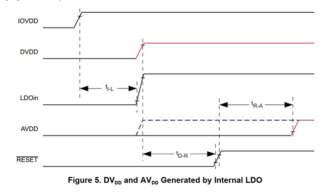

    Here's the power timing I see:
    Blue and magenta are AVDD and DVDD.  Yellow is LDOIN.  IOVDD is applied many seconds before all of this happens.  Cyan is HPL showing the spike.  It always happens right when power is applied.  RESET is held low during this time.
    I would have expected to see DVDD track LDOIN more closely, per Fig 5 in sla492a:
    Not really sure why this is (or if it's important).
    I guess I could add output resistance to slow all this down, but it seems like a hack.  Aren't I doing all the standard/correct things to prevent a pop at poweron?
    Very puzzled by all this!
  • Hi Joe,
    I am out of the office for business travel, but to give you a brief response, are you able to match the diagram where reset goes high and then AVDD goes high at the end instead of matching DVDD?
