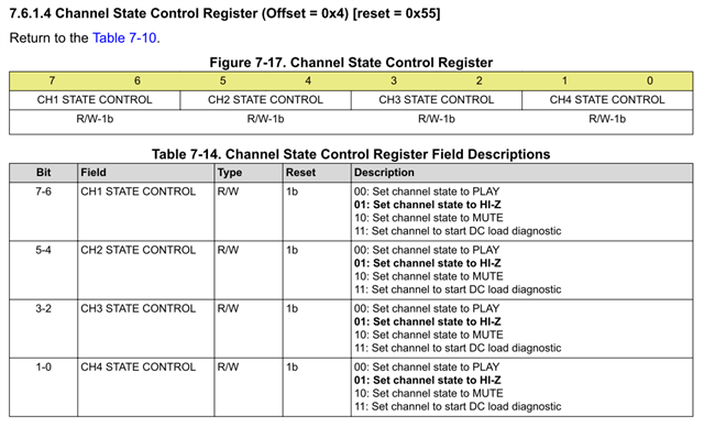

Hi Team,
Just want to double check that, once the device power up, only 0x4 register need to be set to play mode for amplifying the input signal.
Is there any other register need to be set? Thank you.

Hi Mike,
It is good practice to clear any faults at turn on. Then see if the faults return. Also, you should look at the load diagnostic reporting registers, to make sure the load is connected correctly.
Then, if you like the default settings and there are no faults, you make change register 0x04 to set the channels to play mode.
