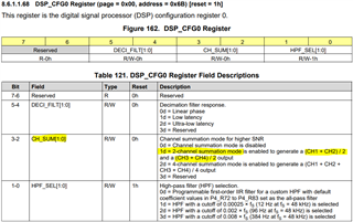

  • Hi Aaron,
    The summing configuration is detailed in D/S section 8.3.6.6: https://www.ti.com/lit/ds/symlink/tlv320adc5140.pdf#page=35
    You may be looking specifically for mode '01':
    However, your schematic suggests IN1 and IN2 both have the same input signal, the same for IN3 and IN4. So my question is would you be summing two signals which are actually the same?
    -Ivan Salazar
    Applications Engineer
  • Hi Aaron,
    Thanks for the additional information. So the reason is to use the 3dB SNR boost in the summing feature, that's clear now.
    Let us know if there are any further questions.
    -Ivan Salazar
