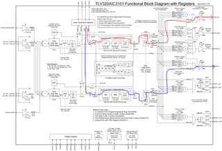

I am following up on a previous ticket here:
https://e2e.ti.com/support/audio-group/audio/f/audio-forum/1136853/tlv320aic3101-unable-to-configure-registers-correctly-for-tlv320aic3101
We are using the above hardware and highlighted audio path. We have the codec operational and are sending out a tone on the left channel only. However, the audio tone can be heard on both left and right headphones. I've reviewed all the register settings and don't see anything obvious. I can mute one of the DAC's and hear that audio stops playing on that headphone, so there should not be a hardware issue with my headphones.
I verified that we're only clocking audio data out for the left channel using an oscilloscope.
Can someone review our register settings to ensure that we are not accidentally mixing the two channels together or using the high power outputs incorrectly?
Thank you.
