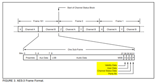

I’m testing a new pcb which uses a  DIT4192 to send S/PDIF to a PCM2906C. The PCM2906c is supposed to output the S/PDIF via USB.
Except I can’t get it to work.
 The analog inputs and outputs of the PCM2906c both work. But I don’t have any use for them.
 USB in to S/PDIF out works fine.
S/PDIF in to USB our doesn’t work.
Using a scope, I can see signal on the S/PDIF in pin. Using an audio analyzer on the same pin, it indicates that the signal is not copy protected and that it is 16 bits. Connecting a DAC to the same pin — the DAC outputs audio.
Can someone please explain why I am not getting a USB output?

    Since the DIT4192 is a SPDIF transmitter it can only output a SPDIF signal to the DIN of the PCM2906C. The DIT4192 would be transmitting the SPDIF signal as shown in datasheet figures 11-14.
    Based on the description in the post above, it seems like there is a packed mismatch between the DIT4192's data packet an the PCM2906C. I would recommend providing the PCM2906C with a packet that works and using a logic analyzer to assess the differences between the working packet and the DIT4192's packet which doesn't work.
    The difference will likely be in the VUCP bits of the data packet shown in the figure below.
    These bits are set by the CUV data buffer shown in figure 2 of the datasheet.
    I hope this helps.
    Andrew
