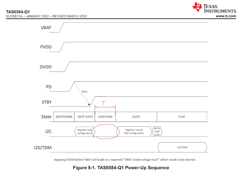

In Figure 8-1, there is this timing diagram:
During the LOAD DIAG state, no communication is made to i2c. This raises some questions:
  • Does TAS ignores all communication during that state?
  • If I ask TAS for a state change during LOAD DIAG, is it latched and will it be applied at the end, or is it just ignored?
  • Assuming each channel has one speaker connected, how long can the LOAD DIAG state last?
    Please see below my comments.
             No, device can not ignore any communication during DC diag.
                You can abort DC diag by register 0xB0.
              If loads no error, 4 channels will cost 155ms typical time to finish DC diag.

  • Hi Marco,
    I think device was running DC diag after PD was pull high. Automatic DC load diagnostics at device initialization cannot be bypassed but can be aborted by setting bit 0 and bit 7 in DC LDG Ctrl 1 Register (Address = 0xB0) to ‘1’ if desired.
    You can try to set bit 7 in DC LDG Ctrl 1 Register (Address = 0xB0) to ‘1’ and then send I2C comments again.
    Derek
