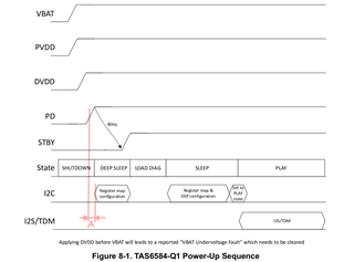

after PDn is de-asserted it appears that the TAS takes time to "figure out" its i2c address using the I2C_ADDR pin. In fact if I try to address it a few microseconds later it does not respond and there is a NAK on bus.
I tried some configurations and tried to investigate the time it takes the TAS to respond:
I2C_ADDR pin addr time
0 pulldown 0x60 ~40us
24k pulldown 0x63 ~170us
1k pulldown 0x61 ~190us
0 pullup 0x67 ~190us
1k pullup 0x66 ~190us
This happens before programming, so it does not depend on some register value.
Is this behavior normal?
