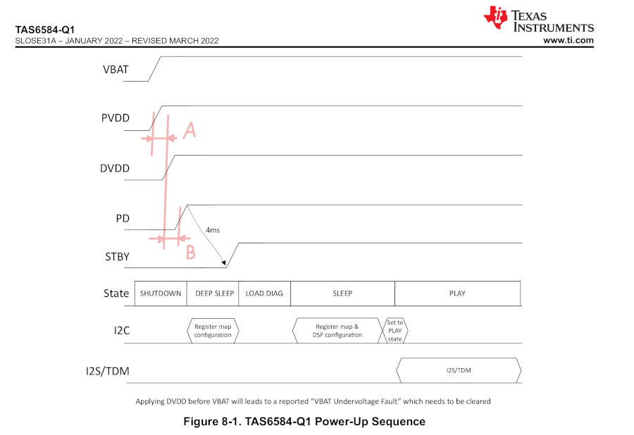

My customer is trying to reduce his startup time.
See his questions below, related to this timing diagram:
We are interested to know the range (minimum and maximum) of time A and B, in particular B.
While we have apparently no problem with the A time, when the time B is too short, for example 130 ms, the TAS channels stand still in shutdown state.
Instead, if it is more than 230 ms there are no problems and we can control the TAS channels as we want.
Could you help to understand this phenomena?
