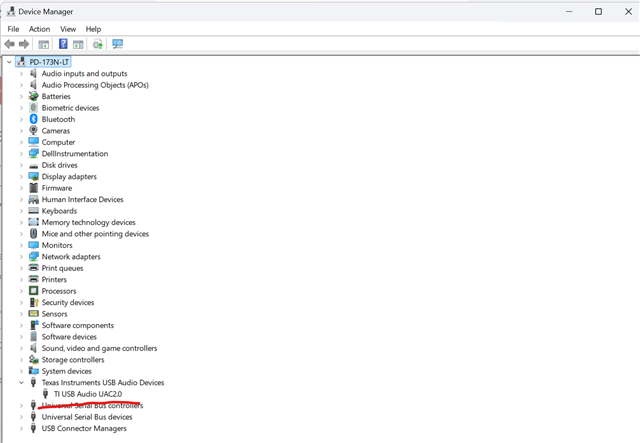

I have followed the procedure in SLAU855A to install the AIC310x GUI on my Windows 11 laptop. When I connect a USB cable to the AC-MODEVM carrying the AIC3104 EVM, I see the USB ready (D1) and power (D3) LEDs illuminate. Despite this, when I launch the GUI I get an error message telling me to connect a USB device.

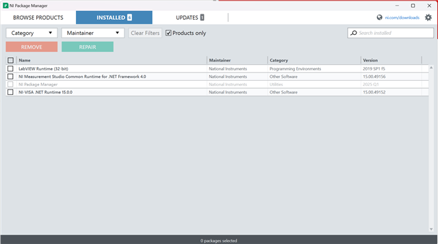

I see a "TI USB Audio" device appear in Windows device manager. I also see that NI Labview software seems to have successfully been installed.
I've attempted removing and re-installing the TI and NI software several times now, without successfully connecting to the UI. I have tested out a second AC-MODEVM and AIC3104 EVM and observe no differences.

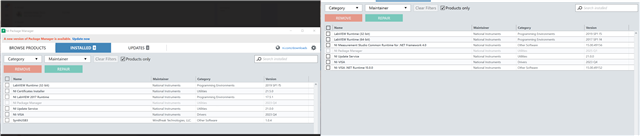

    My coworker and I tried this a couple days ago without success, but I've cleaned the packages off and reinstalled a couple times now so I'll re-install all their packages again to be thorough. The windows 10 machine is on the left, the windows 11 machine is on the right.
    I see the "labview 2017 runtime" on the windows 10 machine, but when I tried installing labview 2017 runtime through NI package manager, it seems to have installed something different. I doubt that is the source of the problem, since the GUI installer installs a 32 bit runtime for 2019.
    One thing I noticed is that on the windows 10 machine, the device shows up in device manager as something like "TI DFU whatever", and says it has a driver error. Again, this is on the working version. On windows 11 (not working) the device shows up as a TI USB Audio device with a working driver. I'm not sure what's going on there, maybe it's a red herring.
  • Hi Andrew,
    The "TI DFU whatever" means that the TI USB Audio Driver isn't able to find the motherboard so the GUI is probably not working correctly at all on the Windows 10 machine even though it claims it's detecting it.
    I have the GUI installed on my Windows 11 machine and double checked that it works. My NI manager is full of stuff from other TI GUIs so I can't quite point to what the missing package may be (if that's the issue). My understanding is that the 2019 runtime is the critical piece. The only other thing I would try to add is the certificates installer that's on the Windows 10 machine.

    I just tried this on a colleague's fresh Windows 11 PC with no NI products installed and it worked immediately. I think something must've gone wrong in the install and there's some kind of conflict. I also confirmed that the only package necessary is the 2019 32 bit Labview Runtime. Would you be able to erase everything related to the GUI and the 2019 Runtime or have you already tried that?
