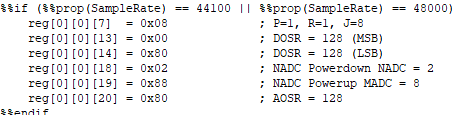

    At the moment I still get the message:
    Generating code for base_main_Rate44 .. assembling ...MemoryType usage: miniDSP_A_coeff: 6, miniDSP_A_coeff0: 1, miniDSP_A_coeff1: 5, miniDSP_A_data: 28, miniDSP_A_instr: 57, miniDSP_A_instr_alloc: 57, miniDSP_A_cycles: 67, miniDSP_A_cycles_alloc: 67,miniDSP_D_coeff: 6, miniDSP_D_coeff0: 1, miniDSP_D_coeff1: 5, miniDSP_D_coeff2: 0, miniDSP_D_data: 12, miniDSP_D_instr: 84, miniDSP_D_instr_alloc: 84, miniDSP_D_cycles: 36, miniDSP_D_cycles_alloc: 36
    Assembly failed
    Error: aic_main.asm(-1): Could not arrange blocks, check addresses and try again
    Robin
  • Hi Robin,
    I tried to recreate your process flow here, and I noticed that it did not fail when the "Multi_Channel_Dig.." were at 4 channels, but when I changed it to 6 or 8, it failed. This has to do with the estimated clock cycles for the miniDSP (such as IDAC/IADC) along with the default clock rates in the SystemSettingsCode commands. I was able to get it to compile correctly when I enabled "SynchMode" - this is an important setting that lets us pass data between the DAC and ADC and vice versa by powering them up at the same time and synchronizing their clocks. It is done through a series of register writes that are already in SystemSettingsCode by default. Let me know if you need more explanation here, but I hope this compiles and works as you expect!!
    Mir

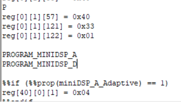

    Very nice. Thank you very much. Now I have the h-file with register values and the cfg-file. Do I understand correctly that the order of writes should be:
    1->system reg values
    2->minidsp A values
    3->minidsp D values
    I also see some pll register writes but not all of them, I think. Is there a way that the processflow will include all the clock settings too? Because I only configured the sample rate to be 48kHz. I never configured any clock input. On the pcb I have a 12Mhz clock to the mclk-pin.
    Are there any other important things in the processflow where I don't know about?
    And is this the right approach? Or do you think it's possible without the minidsp's?
    Again, thank you very much so far!

    I think this is the correct approach for this non-standard routing. I know it is difficult, but we will get it to work!
    The cfg file should have all the PLL settings from SystemSettingsCode, and if there are things left out, they will have been software-reset to the default values from the software reset command at the beginning of the script. And yes, the writes will follow this order, and then have more code at the end (as specified in systemsettingscode). The miniDSP A and D values are set in the "PROGRAM_MINIDSP_A" or D lines as shown, and then the code is generated in that place in the cfg file:
    The clock input will be whatever the default is. It is likely MCLK, if you send your systemsettingscode I can verify for you.
    Are you able to get the passthrough working as expected? It would be a few days for me to check in the lab, earliest I could do it would be next week. So let me know what your status is on getting this to work and I can help virtually here.
    Mir

    At the moment I'm using the .h-file that's created by PPS, because I don't yet have a tool that can read it in and use my I2C converter. I wrote a I2C function for the mcu that's writing the three arrays of structs.
    1. Writing REG_Section_program[ ]
    2. Writing miniDSP_A_reg_values[]
    3. Writing miniDSP_D_reg_values[ ]
    4. I try to do my own PLL and clock settings.
    5. Still have to do the correct ASI settings
    Step 4, I do because then I can just replace the .h-file that's newly created from PPS.
    Now I'm struggeling to get some confirmation that there's something happening in the codec. I tried to configure DOUT1 as CLKOUT to check the clock that's coming from the PLL. The register writes get acked. I can also read them back correctly. Also I tried to configure the DOUT1 as GPO and set it, that's working.
    Probably I missed something here, I'll keep trying.

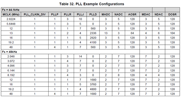

    At the moment I'm struggeling a bit to get the right clocks on the ASI's. The DAC clocktree seems to be configured correct. However the ADC clocktree is not. It seems that the mux between the NADC and the MADC dividers is stuck on taking the DAC_CLK. I tried to configure the clocks for a 12MHZ input clock and Fs of 48KHz as stated in attached table.
    Then I thought if it could something to do with the synchronise function in PPS. But when I comment out the writing of the PPS h-file, the ADC_CLK is still coming from the DAC_CLK.
    My question is: are the values of table 32 right in my situation? Also do I have to bother about the "To DAC miniDSP clock generation" and the "To ADC miniDSP clock generation" labels in figure 58 on page 66 of the datasheet? Because should they be synchronised or not, as per table 32?
    Looking forward to hear from you.
    Robin

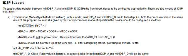

  • Hi Robin,
    First, why are you trying to set DAC and ADC clocks differently? For SynchMode to work, we need ADC and DAC clocks to be the same, so the miniDSP clocks are the same. You can see in the help file for the device in PPS:
    And by default, NADC is powered down in the SystemSettingsCode file. The clocks in that chart you posted should work, but make sure you follow these instructions on how to get the interprocessor working (aka SynchMode). You can see the default system settings code files for when each of these things get set, but I would recommend just changing the section that you need for the 48k option, like here:
    Mir

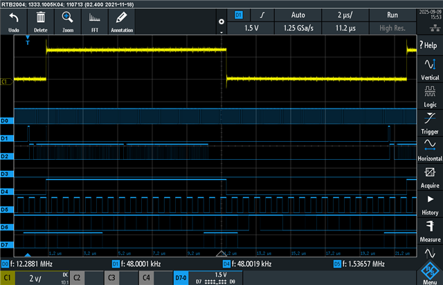

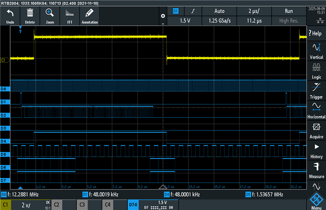

  • Hi Mir,
    Thank you for your response.
    I did this because table 32 said so. However I didn't know.... So now I have the two clocks the same. Also have the right clocks on ASI1-3. Only still have not the right signals on the Din and Dout of the asi's.
    I now have:
    ASI1, BCLK = 12.288MHz, WCLK = 48KHz(8-chn@32-bit, DSP)
    ASI2, BCLK = 1.536MHz, WCLK = 48KHz(2-chn@16-bit I2S)
    ASI3, BCLK = 1.536MHz, WCLK = 48KHz(2-chn@16-bit I2S)
    Then tried to loopback through the dsp from ASI2 to ASI2, that didn't work yet. Now trying with a tonegenerator connected to all outputs to get something out of it. Till now no succes...
    I attached the .cfg and .h file with the tone generator connected to the outputs.

  • Hi Mir,
    In the meantime I tried to get something on ASI1. However no matter what I configure, it seems that it doens't make a difference.
    Below is a scope snapshot of looping back data from ASI2 to ASI2(reg23).
    Whereas:
    D0 = ASI1_BCLK
    D1= ASI1_WCLK
    D2=ASI1_DOUT
    D4=ASI2_WCLK
    D5=ASI2_BCLK
    D6=ASI2_DOUT
    D7=ASI2_DIN
    Below you will find scope snapshot and pfw file of the processflow where ASI2 input is connected to the multichannel output channel 1.
    7418.tlv320aic3268.pfw.txt
    Could you check if it does, what it needs to do on your board?
    Also, what should I use for the "Secondary audio serial adc interface format selection" and the "Tertiary audio serial adc interface format selection" in [0][4][21] and [0][4][33]?
    Robin
