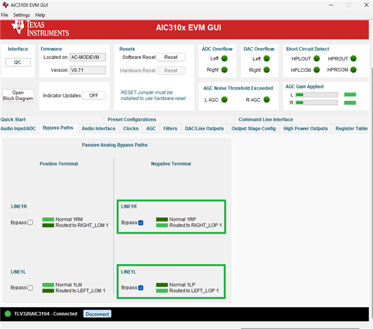

  • However, when testing the same audio settings on the official EVM (TLV320AIC3104EVM-K) using the AIC310x EVM GUI tool, everything works as expected.
EVM Test Results:
We tested two different preset configurations (as shown in the screenshot) from AIC310x EVM GUI tool, and were able to get audio output on headphones and line out based on the settings. To replicate the same behaviour on custom board, we copied the I2C command execution from the Command Line Interface of the AIC310x EVM GUI  tool.
Here is execution logs for each preset configuration  test.

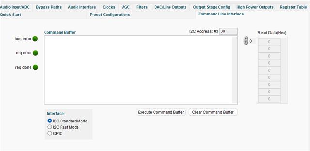

  • Preset Configuration 1 : Stereo Playback to Capless Headphone Outputs,
    These I2C commands produced clean audio output on the EVM:
    i i2cfast
    w 30 07 8A
    w 30 66 A0
    w 30 29 02
    w 30 2B 00
    w 30 0E C0
    w 30 25 E0
    w 30 26 10
    w 30 2F 80
    w 30 40 80
    w 30 41 0D
    w 30 33 0D
  • Preset Configuration  2: Stereo Playback to Lineouts,
    Also worked on EVM with the following configuration:
    i i2cfast
    w 30 07 8A
    w 30 66 A0
    w 30 25 C0
    w 30 29 02
    w 30 2B 00
    w 30 52 80
    w 30 5C 80
    w 30 4B 80
    w 30 4E 80
    w 30 56 09
    w 30 5D 09
    w 30 4F 09

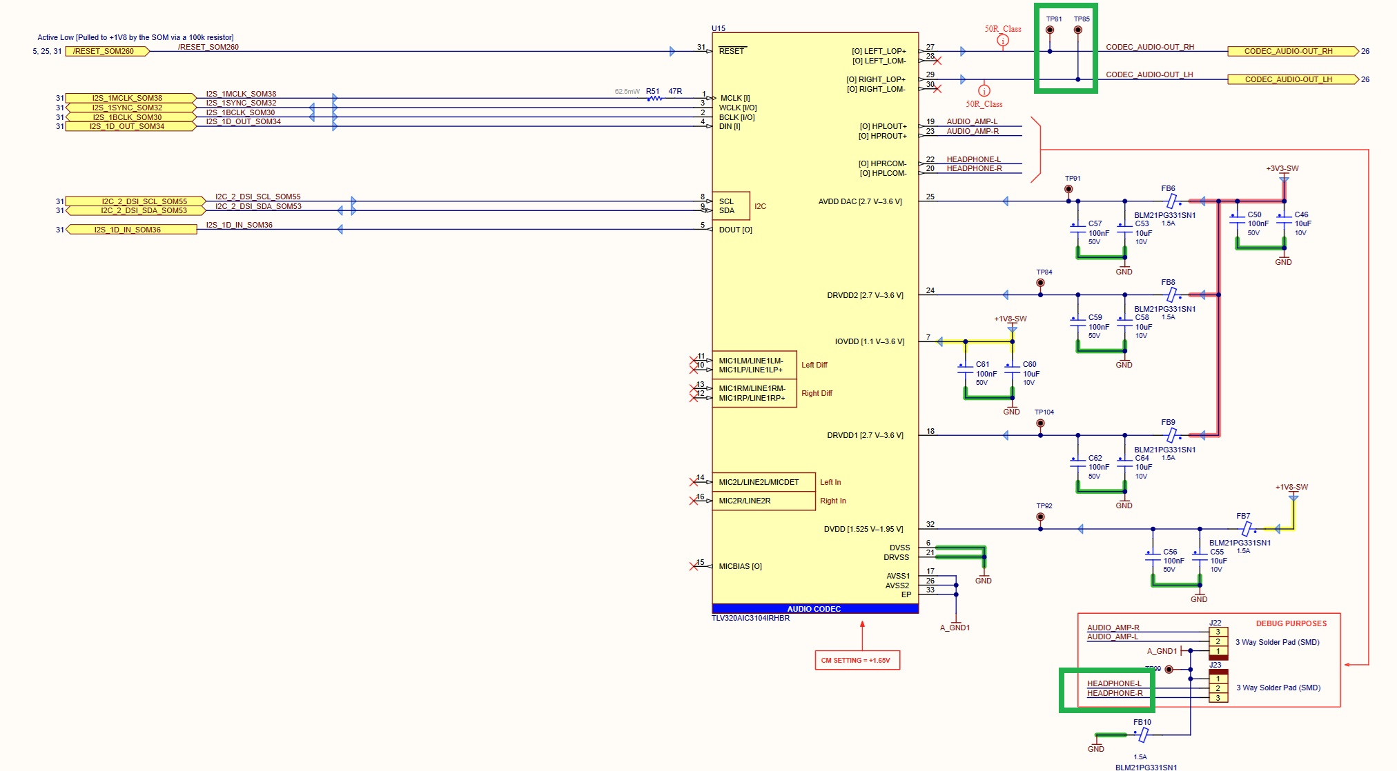

  • Adding a comment to provide more information for this question.

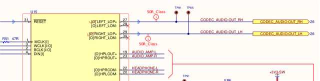

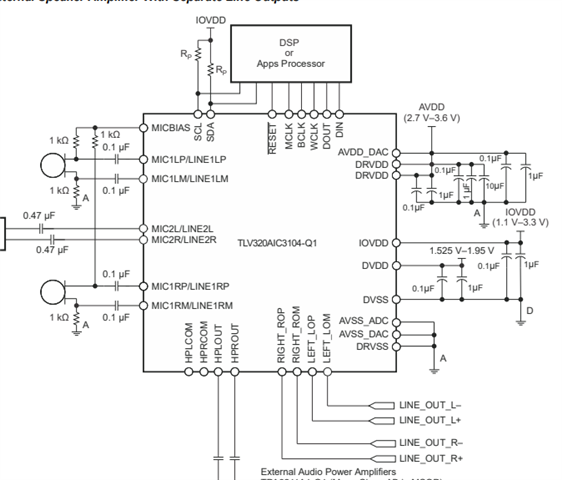

    Below is our codec schematic, and highlighted in green are showing where we are checking the audio signal. Note that on the EVM, we are able to get clear audio out on both of these audio outputs (line out L + R and headphone L + R).
    Here is the Register Table we have applied to our codec on our custom host board. Note this Register Table was copied from the AIC310X EVM GUI software.

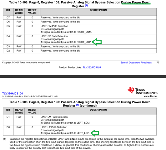

  • Adding another comment, regarding Register 108.
    Per our schematic, we are only routing audio to LEFT_LOP and RIGHT_LOP (line out plus). Based on this, we believe we may need to set Register 108. However, the register name implies this setting only takes effect during power down of the codec.
    Note that enabling these in the EVM does not seem to affect the audio output at the line outs on the EVM line out terminal.
  • Hi Nazar and Vidit,
    There are a few things we can try first:
    I would recommend running the software reset register at the beginning of your script, this would be "w 30 01 80". Then, we can know we are starting from the device defaults. After this, running the script from the GUI should work the same as running the script on the EVM. Another issue I am noticing is that your headphone and audio_amp connections seem to be wrong - normally we would put headphone-L on "HPLOUT+" and it would be referenced to HPLCOM, and headphone-R would be on HPROUT+ and referenced to HPRCOM. So, putting the headphone connections on HPLCOM and HPRCOM will require more attention to the registers that configure those outputs. This would be with register 68 (0x44), which is the routing from DAC_L1 to HPRCOM, and register 57 (0x39) which is routing from DAC_R1 to HPLCOM.
    As for the line out registers, yes you do NOT need register 108 that you shared. The main registers to enable line outputs as DAC outs would be register 82 (0x52), sending DAC_L1 to LEFT_LOP/M, and register 92 (0x5c) sending DAC_R1 to RIGHT_LOP/M.
    Let me know if doing the software reset helps, and if you make progress with changing the headphone routing as I suggested. Or if you need more help with my suggestions.

  • Hi Vidit,
    One more thing, how are you connecting to your line out M pins? I see not connected, but then what are your differential inputs to your speaker? How did you connect it to the EVM?
    Also, I don't think these register dumps are while signal is playing, so it says the line outs are muted. If you can take the reg dump while it is playing it will be more helpful.
    Mir

    Here is the inline response to your questions.
    We have a separate Amplifier board using the TPA3255TDDVRQ1 which has its own differential signal generation. So it is only using Line Out P. Note that we have tested this audio amplifier board, and it is operating properly on different audio setups. So, we are more focused on direct output from the codec itself.

    Below are testing observations on audio signal probing while playing sine wave audio files.
    1. As highlighted in the screenshot, we are probing audio signals at the TP81 and TP85 while playing the audio files.
    Here is probing output on the line out on the custom board
    Where on the EVK line out P+ or M- lines we have clean sine wave audio.
    Note: During the preceding test, we played the identical sine wave file on both EVK and the custom board, and we set up the custom board audio code using amixer setting (2025-08-08 - Register dump Line PCM Playback Volume 70.txt).

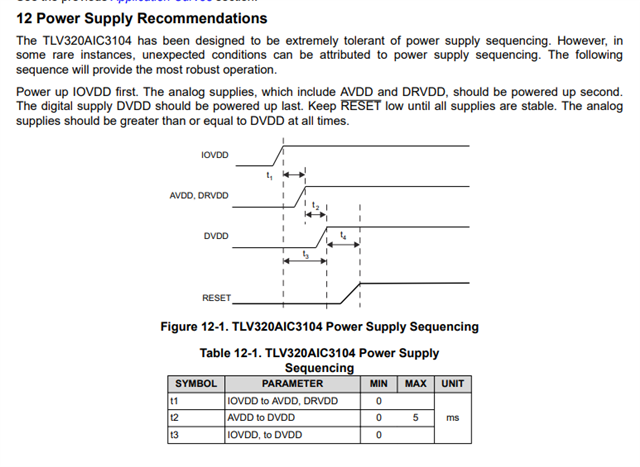

  • Hi Vidit,

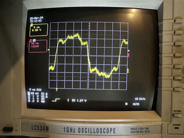

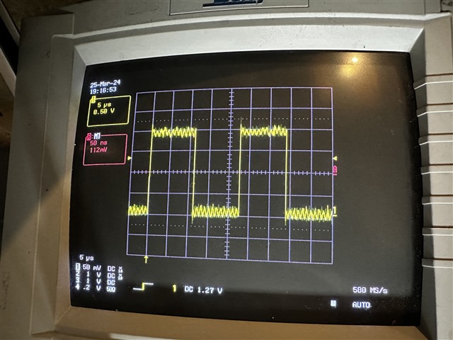

    Can you provide your MCLK rate? I think it may be a clocking issue. Can you measure your BCLK and WCLK clocks out as well? What do you intend them to be? Is MCLK=24.576MHz? Another thing to check is are all the supply voltages coming in correctly? It looks like your output may not be at the common mode of 1.35V, since it looks lower than the example. This may be due to the voltages not making it in correctly, the power supply sequencing may be incorrect. Please follow section 12 of the datasheet for power supply recommendations:
    One more power thing to note is that your IOVDD is 1.8V so all digital signals should be at 1.8V. Make sure your I2S signal in is at 1.8V and not 3.3V.
    Mir
  • Hello  ,
    Thank you for your feedback.
    Please find inline response to your question.

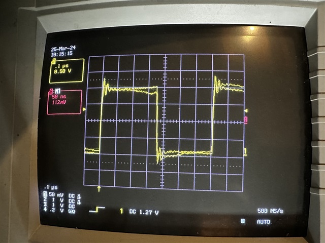

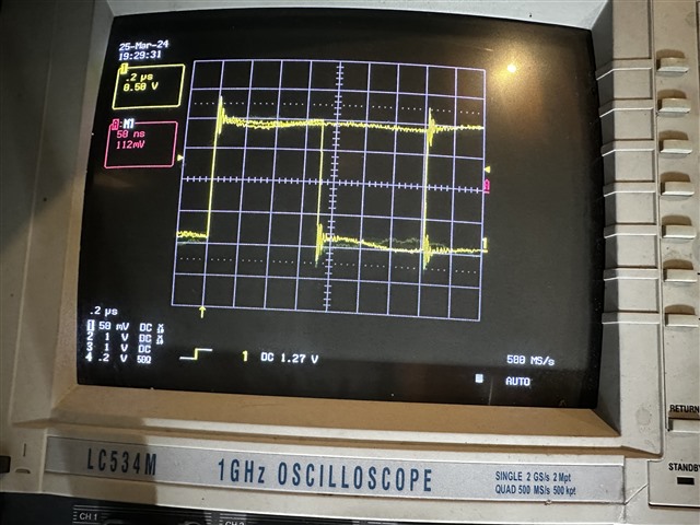

    Ans - MCLK rate is 24.576MHz. Here is a snapshot of MCLK measurement using an Oscilloscope. It is as intended.
    Ans: Here are the Oscilloscope measurements on
    BCLK
    WCLK
    Ans: Yes, all the supplies are coming properly. Here are the measurement readings from different pins.

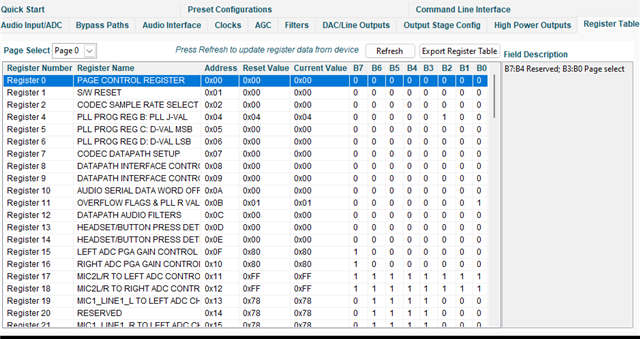

  • Hello Mir,
    It seems to us the EVM register dumps, and even the register dumps from our own board are not working consistently as expected, even based on your feedback.
    Part 1: Register Settings from EVM
    Here is a step-by-step example of this inconsistency using Register 82 as an example.
    Step 1: Apply the following settings using the TI EVM GUI for Left DAC and Left Line Out.
    Step 2. Observe the register table. As expected, Register 82 has a value of 0x80 from the settings we applied in Step 1.
    The value of 0x80 also matches the datasheet description for Register 82. So far so good.
    Step 3. Play audio and refresh the Register Table, since you previously mentioned to capture register settings while playing audio. Here is where the inconsistency happens.
    If we use the EVM GUI to "Refresh" the Register Table, while playing audio, the value of Register 82 gets updated to 0x00. Which is not expected as per the settings and datasheet. See the screenshot below.

  • Hi Mir,
    Here is the MCLK, it is measured around 24.5 MHz during playback, so as expected:
    Here is BCLK, measured around 1.4 MHz during playback (0.1 microsecond per div, 7.1 divs):
    Here is WCLK, measured around 43.4 KHz during playback (5 microsecond per div, around 4.6 divs):
    Looks like your clocks are outputting like it is 44.1kHz mode - this is fine, if you intend to play 44.1kHz files. Can you verify that you are playing a 44.1kHz file, or if it is 48kHz, you should include "-r 48000" in your aplay command? Maybe the resampling is making the audio different than you expect?
    Also, I am about to go out of office for a few days so we may have someone else help here. Can you recap your issue again, and what you have tried to fix it, for clarity?

    3. If we analyze the analogue audio signal, we can confirm it is noisy (see this photo taken by probing line out).
    4. We can play the same audio using the EVM and get clean audio out (see this photo taken by probing line out).

    Here are requested items:
    1. Input signal - as mentioned, we are inputting to DIN on the codec. Going forward, we'll use only the sine 440hz audio. Here is the audio file. It is on Google Drive since this support site doesn't allow uploading files.
    2. Output signal from LEFT_LOP (test point 81) or RIGHT_LOP (test point 85) while playing the 440hz sine. As mentioned previously, we can hear the audio, which is a bit faint, and surrounded by a lot of noise. So the digital input audio signal is coming in, we are hearing the audio playing. That's what's visible while scoping these test points in the image below.
    3. Output signal on LEFT OUT + or RIGHT OUT + on the EVM while playing the 440hz sine. The audio is clear, and we get a nice clear sine wave while probing these outputs.

    Have we verified all potential issues with your register dump? Could you re-measure the changes during playback of the register dump? You can also check the register dump of the EVM in the GUI, you can verify the changes in the GUI that you are making line up with the registers that are being set in the Linux system. Any settings set through the GUI are actually sending I2C commands to the chip, and the GUI should save it in the "Command Line Interface" page as shown here:
    Then, you can export the registers set in the device on the "Register Table" tab as shown here:
    You can check the register table with your register dump of the custom board, and I can as well if you send it over.
    Mir

    I wonder if this is a hardware issue. I notice that you did not separate analog and digital grounds on DRVDD and AVDD, so any analog ground connection on the output would also be incorrect. Can you separate analog and digital grounds and continue to test? Noise in the output may be a power supply/separation problem, or a connection problem.
    Mir
    Do you mean DVSS, DRVSS (which are connected to GND) and AVSS1,AVSS2,EP which are connected to A_GND1? If not, please let me know which pins you are referring to.
  • Yes, we can see example of A and D grounds in the datasheet for the device:
    And also, the way that you would be measuring your single ended outputs will need a ground, make sure you are using analog ground as well.
    Yes, we thought of this previously, so in our design, we shorted A_GND1 and GND together.
    - This eliminated a background hiss while audio was not playing.
    - But the noise while audio is playing remained unchanged.
    Note in addition to just scoping the line out signal, we are also outputting the single-ended outputs to an external amplifier, and can hear all the noise with the audio.
    I mean adding A_GND1 instead of GND to your AVDD, DRVDD, and audio signal connections. Of course analog and digital ground need to come together to be connected, but they should come together at a central point like underneath the chip.
    Another note is do you still see the noise when you do not have the amplifier connected? Or do you still hear the noise when you are not scope connected to the line out? Maybe some impedance/noise problems with these two connections at once.
    Mir
