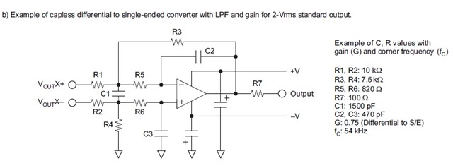

I am working on an audio design using the PCM3060 and I have a question regarding the output stage—specifically about output gain and low-pass filter component calculations.
I couldn’t find clear guidelines or example calculations for setting the output gain.
How should I choose resistor and capacitor values to achieve a desired output gain?
