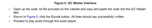

Hi expert,
How to generate code.txt? Thank you!
www.ti.com/.../tiduen4.pdf
BR,
Zach
  • Hi Zach,

  • Hi Sydney,
    After writing.txt, there will be about 1s of pink noise when it is about to be completed, and there will be no sound after writing is completed.
    Could you pls give some advice about this issue? Appreciate your help!
    BR,
    Zach

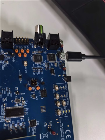

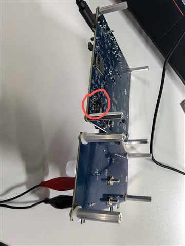

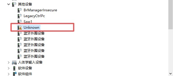

  • Hi Sydney,
    I have some news to share, and I'm afraid it's not good.
    There is something wrong with 5825M and 5825M-SB. When the USB is plugged in, the blue communication light does not light up normally. Device driver is unknow.
    The red circled part is very hot after power is turned on.
    Could you help give me some ideas on how to solve the problem? Thank you!
    BR,
    Zach
  • Hi Zach,
    Interesting.. this is a new issue right? This was not occurring when you first got the EVM(s)?
    Are you having this issue with the TAS5825MEVM-SB and the normal TAS5825MEVM? Can you try different USB cables and ports?
    Sydney Northcutt
