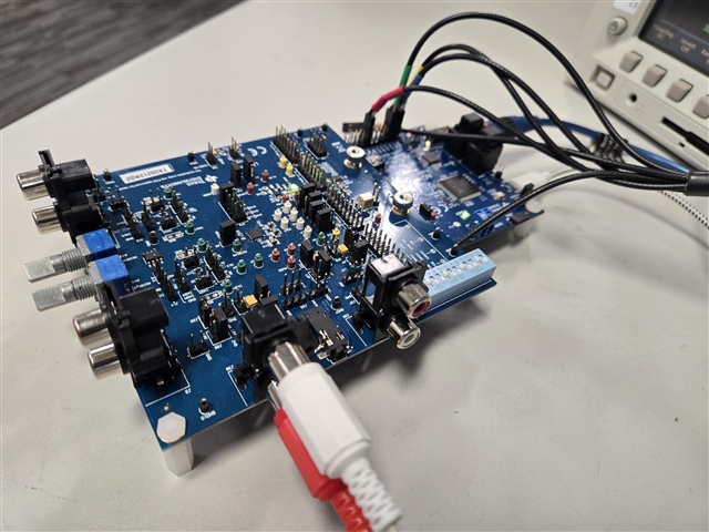

My setup at the moment is: Linux PC playing an audio file through a Evaluation USB-I2S Board for it to get converted to I2S signals, and these signals are passed in to the TAD5242EVM-K. The photo below is the configuration that I am following. I have also verified that the I2S signals are all working fine.
My questions are:
1. When I play the audio file (e.g. 1kHz audio file) from my PC and I observe the signals for OUT1/2P and OUT1/2M, there seems to be no output coming through. Why is this so?
- Only when I changed the USB-I2S configuration to a 16-bit FIFO element, Audio sample size = 16 bits, number of bits per channel = 32, and change the FSYNC to about 49kHz, then the right output signal will show
2. Do the sampling frequencies of my Linux PC and the evaluation board have to be the same value for it work? e.g. both have to be set as 48kHz at 16 bits sample size
Let me know if you need more information.

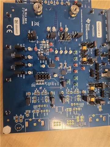

    Also for your ref I am including the picture of my EVM, but I would concentrate on the clks to resolve the issue.

  • Hello Jon
    MD3 in  Controller mode is the Controller clock input but for Target mode Short directly to board ground plane.
    Per data sheet the available formats in both controller or target mode are  TDM, LJ or I2S  and  Word Length is  24 or 32 Bits.
    Try a 24 or 32bit data ( and recalculate the needed BCK) if still you have any issue, then make sure the data format  matches with your jumper setting.
    Most likely your BCLK is too low.
    you can refer to EVM jumpers in my other post to make sure you have them  correct for your data format:
