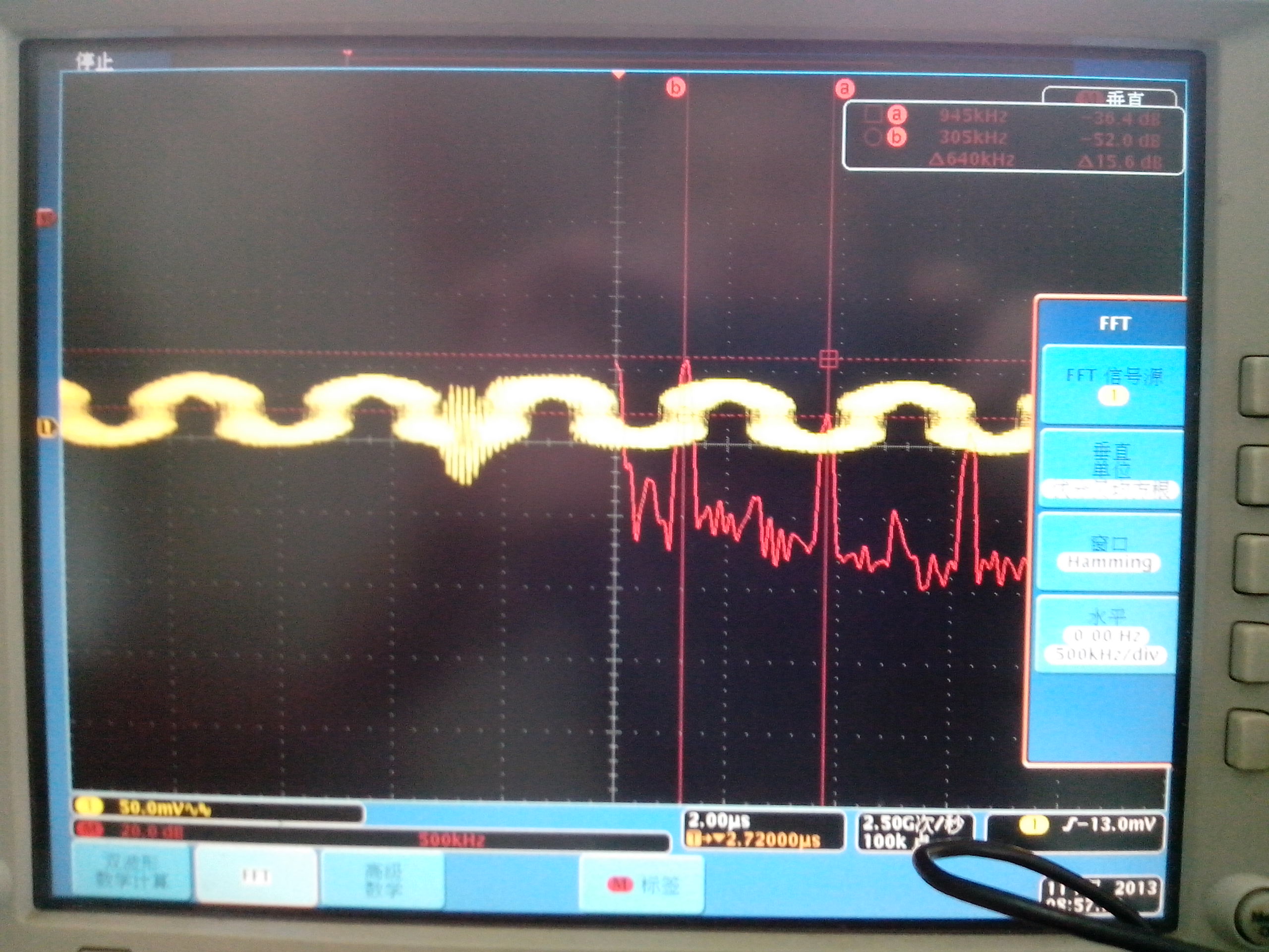

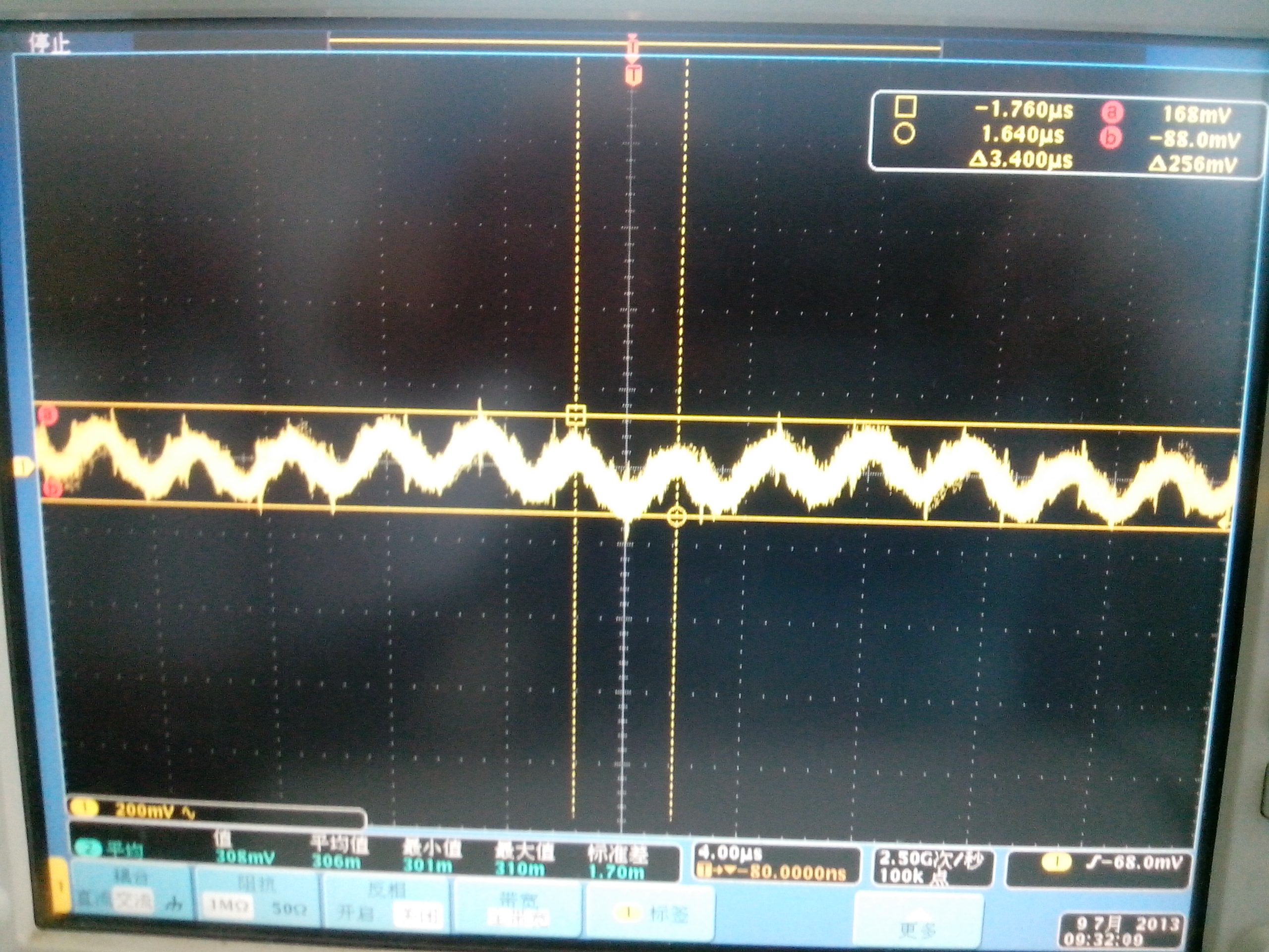

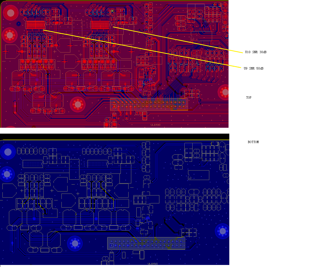

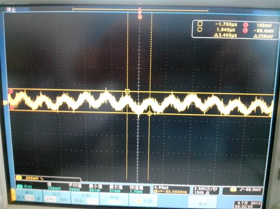

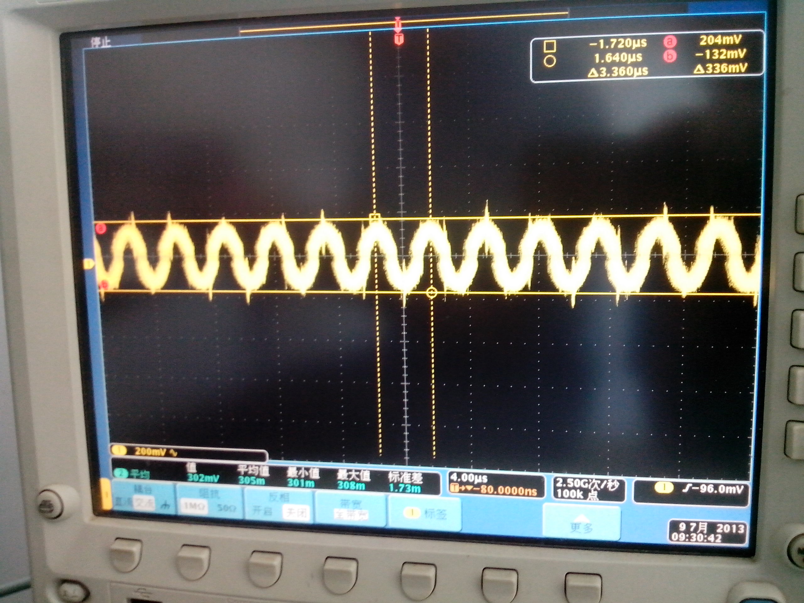

Dear Sir,
  We've met a strange problem recently. We using 2 pieces of TPA3110D2 for a 4X4 OHM speaker, and one pieces of TPA3110D2  SNR is 50dB, the other is 30dB. The two pieces of TPA3110D2 circuit are the same, the only diference is Layout.  Will Layout impact so much?
