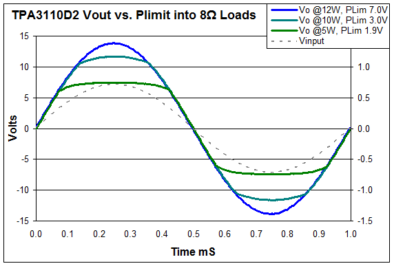

  I've just designed a board with TPA3118, and need to limit TPA3118 max output power to 10W.  there is  2 quesitons for Table 3 in the page 17 of TPA3118 spec.
1. Does the max output power = Vrms * Vrms / Rload?
    For example, in the last row of Table 3,   Pmax= 6.3*6.3/4 =10W ( for a 4 OHM load)? Is this right?
2.  Is the max output voltage only decided by the Plimit voltage or related with gain value and input signal voltage?
