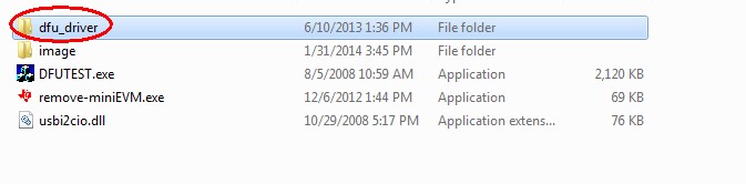

  • Hi Sean,
    which version of firmware do you want go update? in your firmware folder, you could find dfu_driver.
  • I would like to get back to the 44.1k firmware to be able to use the device for standard audio.
    I have applied the driver found inside the dfu-driver folder that you show above using update driver in Device Manager in Windows (since no driver was currently applied).
    After applying the driver, the EVM shows up as DFUUSB in device manager but the D2 USB audio light on the EVM does not enable and AIC3254 CS still maintains that no EVM is connected after reopening the application and unplugging/replugging the EVM board.
