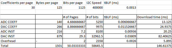

  • Hi Ji-Yong,
    Of course, the best solution is to ask customer to use 5MHz or so SPI, which increases download speed > 10x.
    For AEC process flow, it seems that the download time might not be optimized. Based on the script you provided the download time would be close to 150ms, not 1 second. I suggest you to verify the I2C transactions on a scope to observe the timing. Also, make sure C-RAM and I-RAM bytes are sent as 120 auto-incremented bytes per page (30 coefficients / instructions per page). For each C-RAM/I-RAM page write, there are 120 bytes of data + 2 + 3 bytes of overhead to set page.
    The I-RAM memory is retained even after a software or hardware reset. So one trick is to write the I-RAM section once at boot-up (or whenever power is removed) and then skip I-RAM writes for mode changes (write everything except I-RAM). This should save around 65% of download time when switching modes conpared to downloading I-RAM. With my calculations, this should take 44ms.
    Summary:
    • Fix i2c communication / i2c script parsing such that the result is close to 150 ms.
    • Do the I-RAM trick to reduce download time close to 50ms.
    • If the above is not possible, use SPI.
    Let me know if you need clarification.
    Jorge
