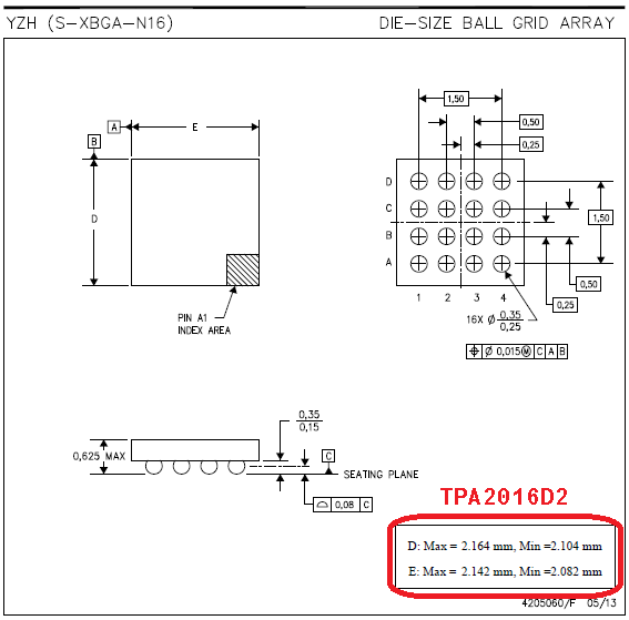

TPA2012D2 Dimensional Tolerance of DSBGA Package Size
Could you please tell us the dimensional tolerance of DSBGA package size for TPA2012D2 such as following TPA2016D2 since we could not find it in TPA2012D2 data sheet ?
