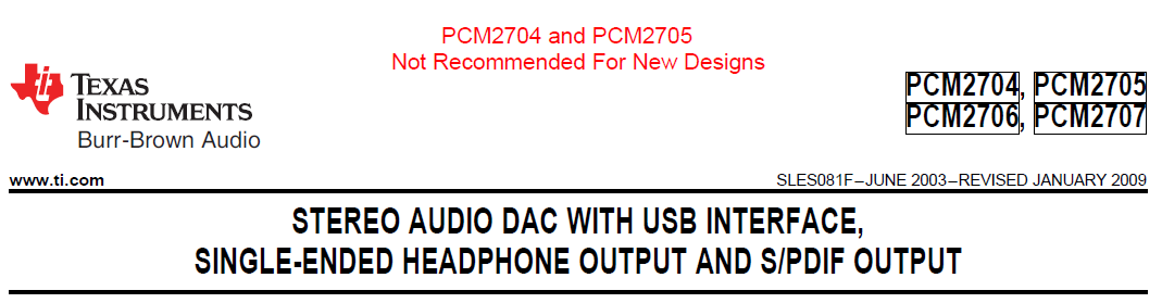

Q3) NRND products
About PCM2704/2705, both devices are already difined as "NRND" products.
How about PCM2706/2707?
Can I still propose both devices to my customers?

    Q3)
    PCM2704 and PCM2705 are only available in C revision version.
    The recommendation is to use the C revision devices for both DAC and CODEC families, as these are updated versions. (PCM290xC/PCM270xC)
