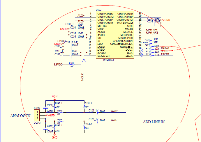

The customer want to configure the PCM1863 as differential input (VIN2P, VIN2M). The schematic is shown as below,
Case 1: When they add signal on pin 1 & 2 of ANALOGIN, the loudspeaker makes a sound.
Case 2: When they add signal on pin 3 & 2 of ANALOGIN, the loudspeaker makes no sound. I have observed that there were signals added on pin VIN2M.

    I used your register settings on the EVM, and it seems to work, is the speaker playing the audio from the right channel or the left channel? It seems in the schematic that the + and - signals are reversed for the input into the ADC, but this should stop audio from being captured.
    For the 0x1 and 0x2 register writes, am I correct in assuming you meant 0x01 and 0x02 for the register address?

    And I'm sorry for make a mistake, the phenomenon should be:
    Case 1: When they add signal on pin 3 & 2 of ANALOGIN, the loudspeaker makes a sound.
    Case 2: When they add signal on pin 1 & 2 of ANALOGIN, the loudspeaker makes no sound.
    Do you have any suggestion to debug it?

    The registers 0x06 and 0x07 select which input pins will go to the two ADCs in the part. Am I correct in stating that AUX+ and AUX- go into pins 2 and 4 in the schematic above? this means that setting register 0x07 to value 0x50 (keeping the reserve bit high) will set the input to the Right ADC as the differential pair of VIN2M and VIN2P. From this you should see data on the right channel in the I2S data. If your amplifier is set up to play the right channel audio you should then hear it on the output. If your amplifier is set up to play audio on the left channel and you don't have the PCM1863 MUX settings correct, you will be getting VINR1 audio output from AUX-.
    To verify this, get a capture of the data line with the LRCK, and check what channel data you see when you change settings/inputs.
