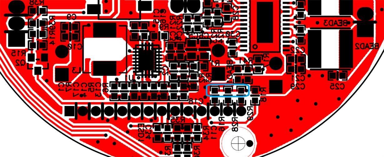

I have meet noise issue on TPA3140D2, please refer to below test waveform.
Any point need I check first?
I will provide schematic and layout later.

  • Hi Sir,
    We have tried connect C19/C20 to GND or floating, this noise will disappear. Do you have any idea?
    below is schematic and layout.

  • Hi Jeff,
    Form your PCB files, looks like the AMP net are connected to CHARG_IN, is this expected? I think you need to check the input circuit to make sure the input path is clean.
  • Hi Shawn,
    I think it no connect to CHARG_IN, you can refer to below figure.
    And now we tried disconnect C20, but still can measure 10kHz noise on pin12.
    And I check almost layout meet layout guide.
    Thanks!
    Jeff

  • Hi Shawn,
    We have tried change SSCTRL pin to connect GND, found can solve 10kHz noise, do you have more detail about Spread Spectrum and De-Phase Control?
    Why it cause 10kHz noise?
    Thanks!
    Jeff
  • Hi Jeff,
    When spread spectrum and de-phase control are enable on TPA3140, the THD performance only decreases around 0.5dB.
    The 10kHz noise shown in your picture is very large, we think it probably comes from the power ro GND. The noise is coupled to input, then it's enlarged by the 36dB gain on the audio amplitude. You can try to use differential input mode to mitigate the noise on input. And, the GNDing is also very important for the noise mitigation, please also check the GNDing performance on your board. With good GNDing and differential input mode, the 10kHz noise should be empressed a lot.
