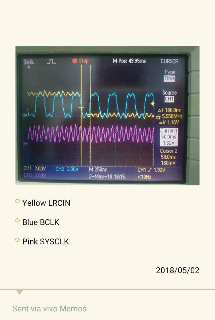

  • Hello Diego,
    We are using the settings for program registers provided in previous reply for I2S mode on Audio Codec PCM3002
    We have below observations:
    - Dout is generating clock without any input sound file
    - Once sound file is played using ALSA drivers, Dout output zero and Vout becomes Vcc/2
    - system clock is set to 13.2 MHZ, bit clock is coming around 2.79 MHZ, LRCIN is 48 KHZ for audio file of 48KHz.
    Please refer to attached waveform results for audio file with 48 KHZ frequency.
    As mentioned in PCM3002/3003 datasheet,  if system clock and LRCIN are not synchronized, then Dout output results in zero and Vout becomes Vcc/2.
    We are under impression that our system is going into this mode. Is there any way to confirm this?
    If this is not the case, please suggest what could be the cause, for not getting Dout and Vout in normal mode.
    Prashant
  • Hi, Prashant,
    From the information you shared, it seems the issue is related to a clock error, this device expects to have 32, 48, or 64 bit clocks in one word clock, otherwise the clocks will be considered as invalid. In your application, BCLK has a frequency of about 58×Fs, which is not supported by the PCM3003. Also, system clock is running at 275×Fs, which is not supported, only 256×Fs, 384×Fs and 512×Fs, frequencies are supported.

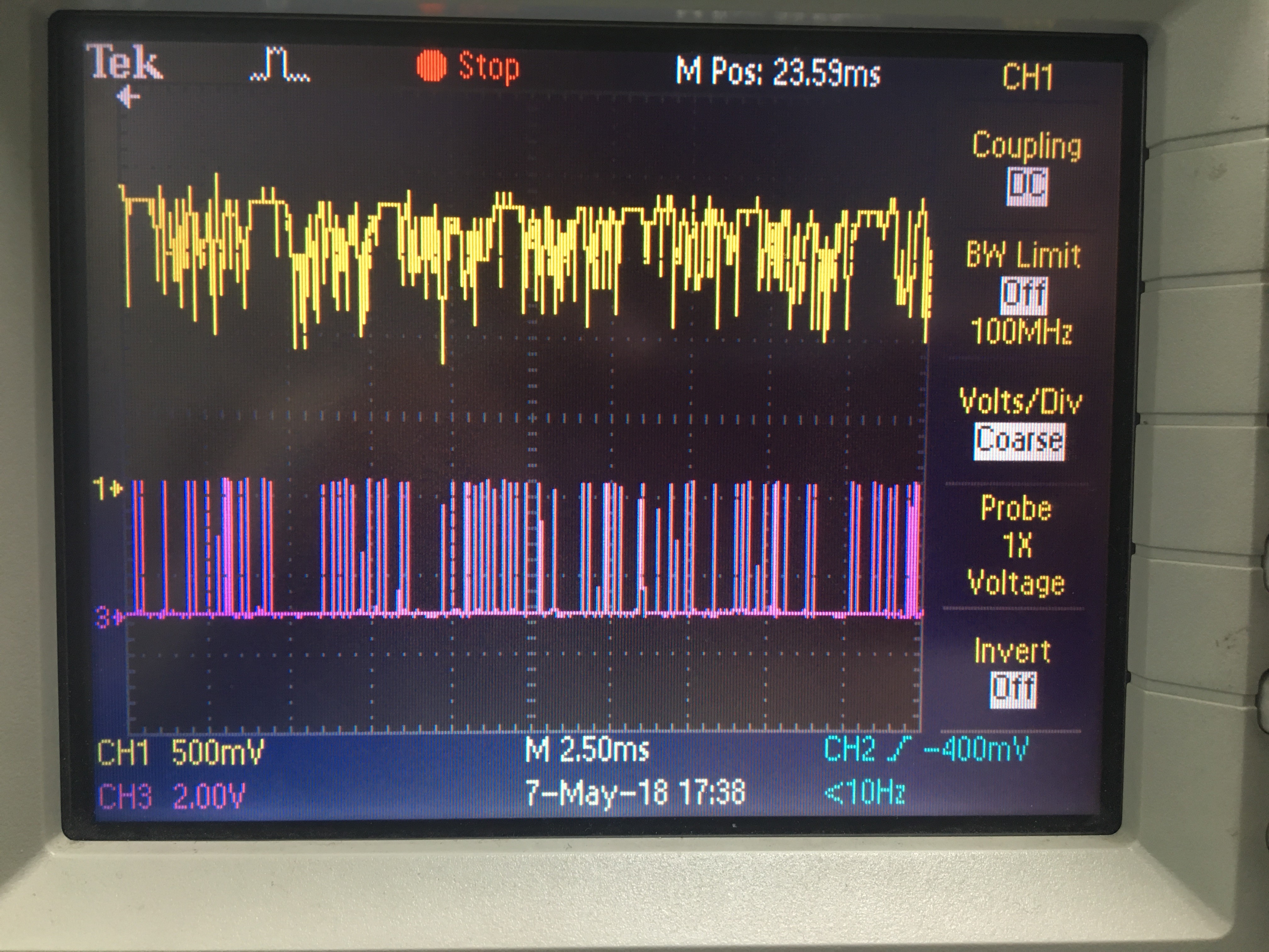

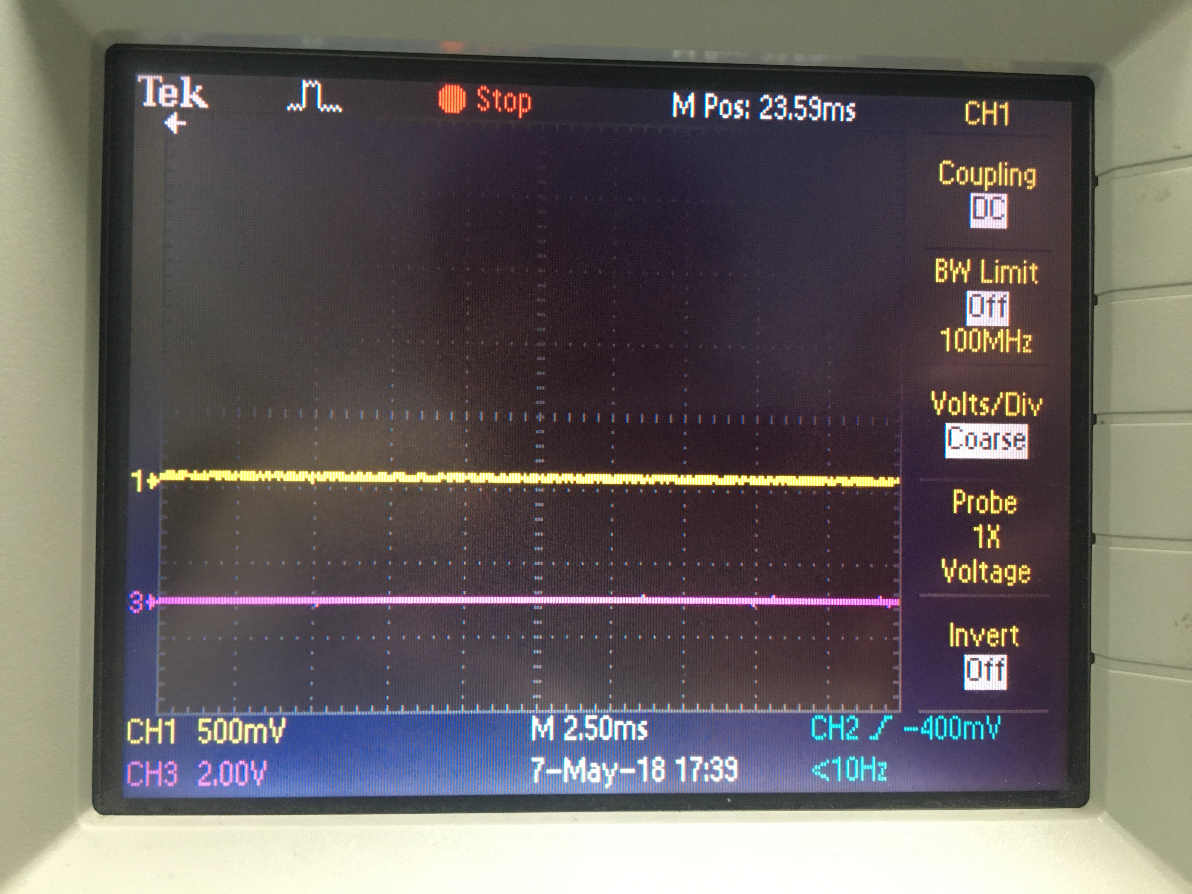

  • Hello Diego,
    Please find below details:
    Graph 1: Audio play output
    Yellow Waveform: Dout
    Pink Waveform: Vout
    Graph 2: Without Audio play
    Above output captured with same settings as mentioned earlier.
    Please find attached word document with the procedure, detailed waveform and timing diagrams created while working with PCM3002 interfacing.
    Do let me know if any missing step or some other issue(s).
     Audio_Codec.docx
    Thanks.

  • Hello Diego,
    Referring to last waveform shared about Vout and Dout, there has been mistake while tagging those waveform.
    Yellow colored waveform indicates Vout output and pink one represents Dout output.
    Unfortunately, we do not have another digital audio master to test on. Most probably, program register settings done through bit banging seems to create some issues. As with reset and after setting up program registers, we are getting same results on output pins. Plus, even after enabling Mute, we are receiving output at both the pins Vout and Dout. Document (shared in last reply) provides details about timing diagram while setting up program registers. Please confirm if the actual time frames are in valid ranges or not.
    Prashant
  • Prashant,
    After looking at the control interface clock specs,it seems the signals used to configure the part are faster than the expected from the device. I am not sure if this could be an issue, there is not much information about this type of interface, so the only recommendation I can provide is to try changing the configuration signals to make them slower and meet the timing details from the datasheet. The I²S clocks seems fine, but my only question would be to verify if effectively the data starts one bit after the LRCK changes (as should be on I²S format). One other suggestion I have is to set the host processor to operate in left justified mode and operate the PCM3003 in default mode without any configuration.
