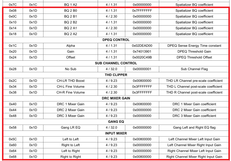

Our customer found the registers which aren't mentioned in the application note "TAS5782M Process Flows " if dumping the DSP memory.
So, could you please tell me that registers in detail as below ?

  • Hi Alix-san,
    I would check the undefined registers in the application note "TAS5782M Process Flows" as below, so could you please explain the function for these register in detail ?

  • Hi Kato-san,
    Please see file attached. This is for 2.1 mode but works for 2.0 too.
    TAS5782 48K_2.1 mode Processflow Register Map.docx
    Alix Wan.
  • Hi Alix-san,
    Thank you for the information.
    I would like to confirm just in case, is 2.1 mode memory map same with 2.0 mode memory map for process flow3 ?
    Kato
  • Hi Kato-san,
    Yes it is also appliable for process flow3: 48KHz, 2.0 Standard Flow.
    Alix Wan.
