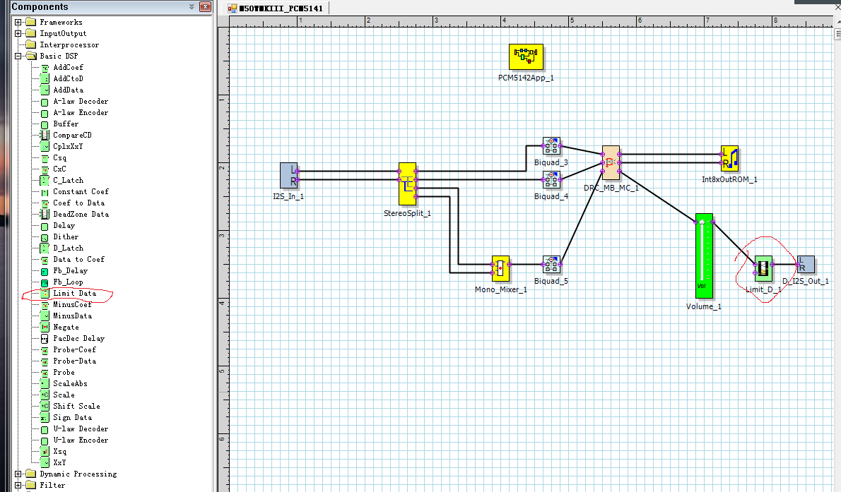

Custome want to use the 'limit data' module in the GDE software of PCM5142, but we can't know how to use this module . How we connect the input ? Is there any user gudie for this ?

Right-clicking any module and selecting "help" will show some information on how to use the module.
As the help menu describes, this essentially acts as a digital limit, and will "clip" the output.

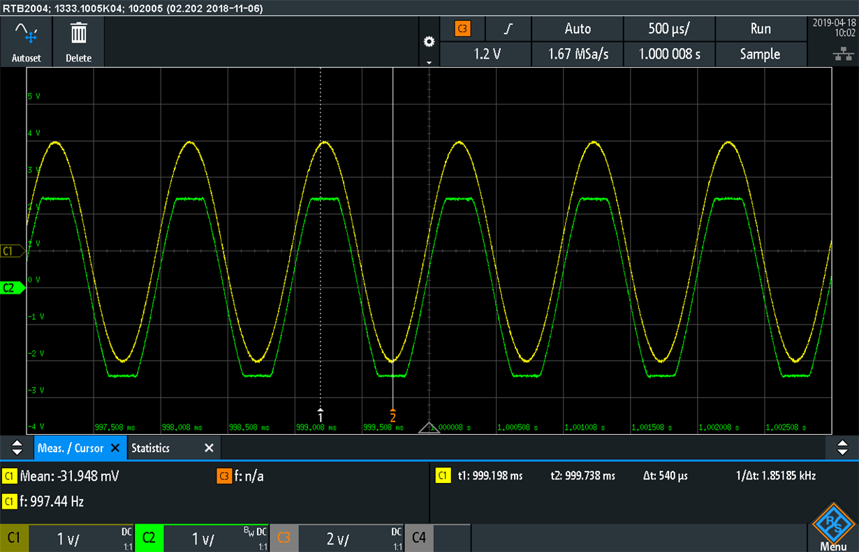

Here is how I implemented it, for example. I use the coefficient of 0.8 to in the C_to_Data block.
As a result, the right channel was limited to about 80% full scale, compared to the left channel.
