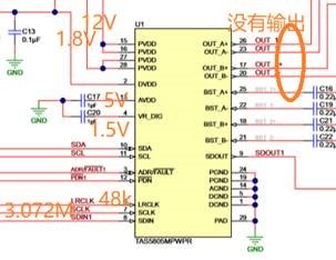

TAS5805MEVM: (APQ845) Linux+TAS5805M EVM: No sound output
Part Number: TAS5805MEVM
Other Parts Discussed in Thread: TAS5805
snapdragon+EVM TAS5805, but no sound output.
input information as attached pic.
Would you please give some advice?Thanks.

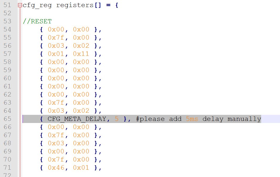

  • Hello Customer,
    As to your questions, it is suggested to :
    • Please refer to the guidance below to figure out what root cause is:
                   TAS58x5 Trouble shooting.pdf
    • Then please check whether sequence on page 43 of the datasheet:
      • note that I2S clocks are needed to be stable when doing I2C configuration;
      • During the I2C configurations, please make sure 5 ms delay is implemented for device settle down. The 5ms delay can be found in .h file dumped from PPC3 GUI.
    Alix Wan.
  • Dear Alix,
    Thanks for your information, where can .h file for 5ms delay? what's meaning of  be found in .h file dumped from PPC3 GUI?
    We just do 0x00,0x00 and loop 5 times. but 5805 still can not work.
    Would you please guide more?
    Thanks.

    1. Dump head file from TI PPC3
                 6886.How to Generate a Header File fro TAS5805M in PPC3.pdf
    1. Explanation of 5ms delay in head file
                Usually, TI recommend customer to use the PPC3 GUI to dump the head file. TI has implemented power on sequence in the head file. Please see below:
     TAS5805_Head_File_Example.h
    Alix Wan
