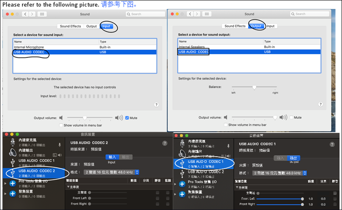

PCM2900C & B How do I change the device name on my computer
  • Hello user,
    The device name is hard coded into the PCM2900.  You cannot change it.
    When this device was released TI did offer to do custom runs of the device with a different name, but we no longer offer this service.
