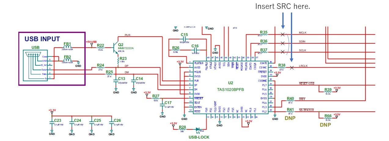

I want to start the learning process with PP-SALB-EVM, but I'm running into an audio sampling rate mismatch issue because I can only use Windows 10.
Similar problems have been reported in E2E.
http://e2e.ti.com/support/audio/f/6/p/697896/2586698#2586698?jktype=e2e
Is it possible to solve this problem by inserting SRC between I2S communication?
Thank you.
Aki
  • Hello Aki-san,
    If you do not have access to the "Advanced" tab in the line properties (as expressed in the similar e2e), please do the following steps:
    a. Open Device manager
    b. Under "Sound, video and game controllers" find "USB-AudioEVM"
    c. Right click this driver and "Uninstall Device"
    d. Unplug USB, re-plug in USB into computer, this will allow the correct driver to be recognized by the computer.
    Please let me know if this allows you to access the Advanced tab. The driver error sometimes occurs when using several TI Audio EVMS (for example: Learning Board & Motherboard).
    All the best,
    Carolina
  • Hello Carolina,
    Thank you for your advise!
    I was able to solve this problem using the steps you have given me.
    Thank you.
    Aki
