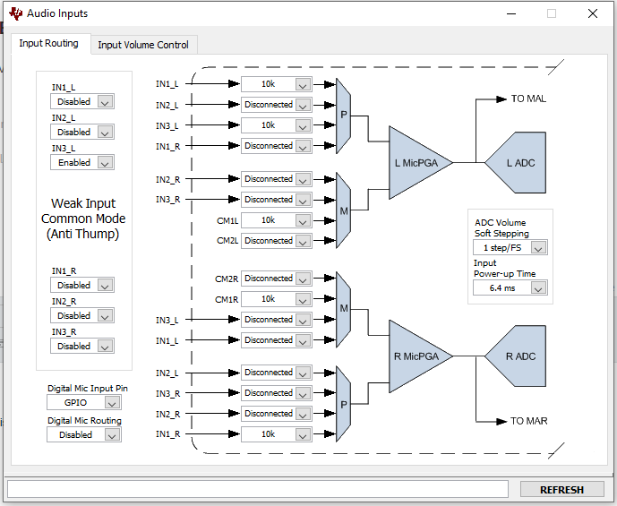

  • I have an other question.
    Now the AIC3254 works as well but I dont understand how can I configure the input in a way to use my microphone as an input. I tried to change some parameters in AIC3254 (Audio Input)   but nothing works..
    Any advices would be interesting.
    Matthieu
    Are you using the onboard mic or are you using an external mic? If you are using external mic to which connector have you connected the mic?
    The EVM users guide covers most of the regular use cases and can be accessed here : https://www.ti.com/lit/pdf/SLAU264A\
    Best Regards.
    I am using an external mic connected to J5. This way i run the AIC354 and set 10k to IN3_L
    And nothing works...
    I hope we will find a solution

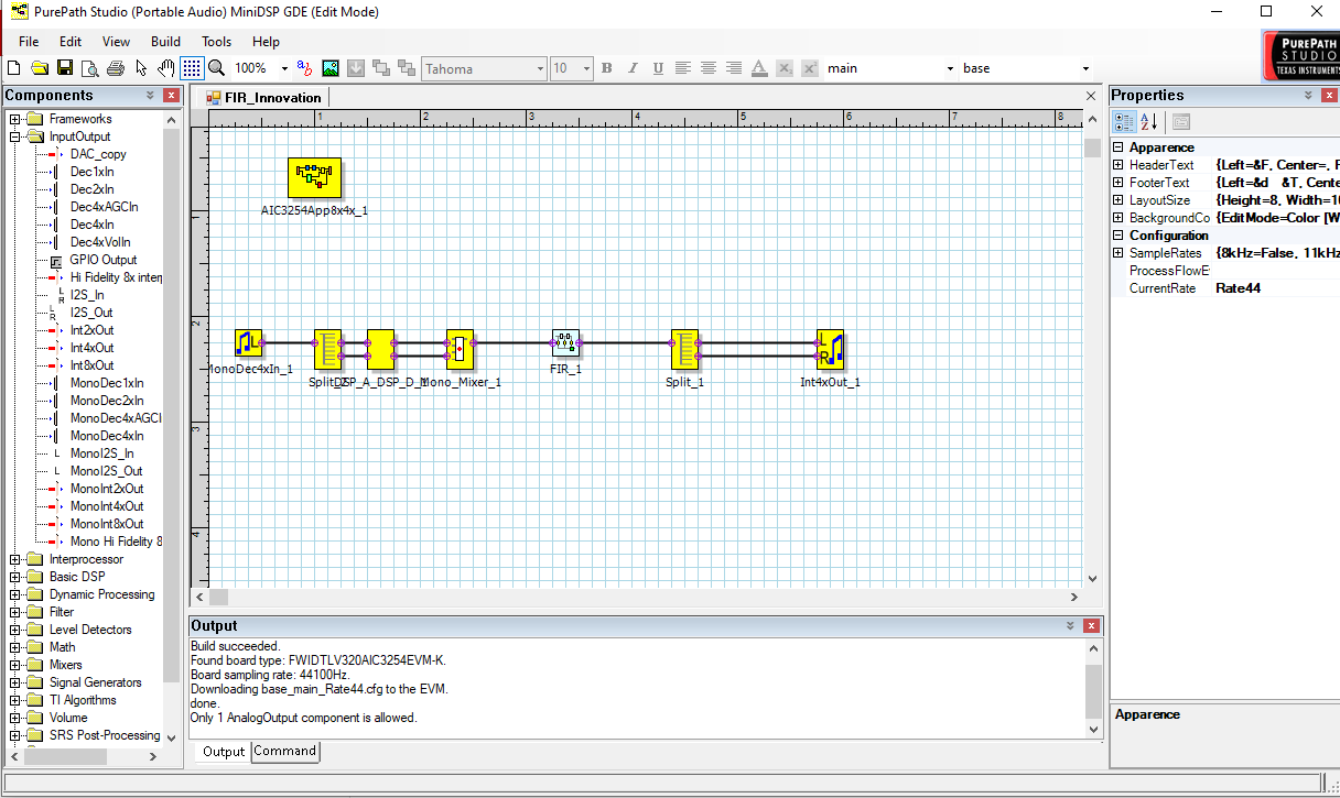

  • Ok it works as well to hear my voice without filter, but i can't test the GDE filter for now.
    Are you able to solve this ?
    Matthieu
  • Hi Matthieu,
    In the GDE too, the same device settings have to be applied. In the on-board mic. case the mic is connected to IN3.
    Please refer to the following thread for modifying the device configuration of a PPS process flow.
    The key registers to enable and route the on-board microphone are the following three Page 1 registers.
    # Recording Setup
    # Select Page 1
    w 30 00 01
    # Powerup MIC BIAS
    w 30 33 40
    # Route IN3L to LEFT_P with 10K input impedance
    w 30 34 04
    # Route IN3R to LEFT_M with 10K input impedance
    w 30 36 04
    In the GDE Systems-Setting code this would correspond to the following three entries and the procedure for that is shown in the linked e2e thread -
    reg[1][0x33] = 0x40
    reg[1][0x34] = 0x04
    reg[1][0x36] = 0x04
    Let us know if you face any issues.
