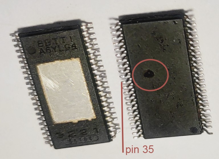

Hi team,

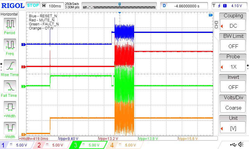

I apologize for a late reply, but i didn't have opportunity to work with TPA3221.
In the meantime I have created a smaller development variant where other modes can be set, but it is still not functional.

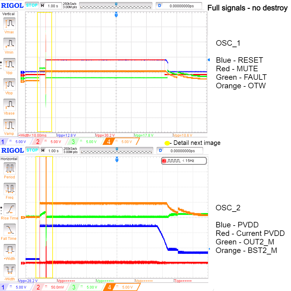

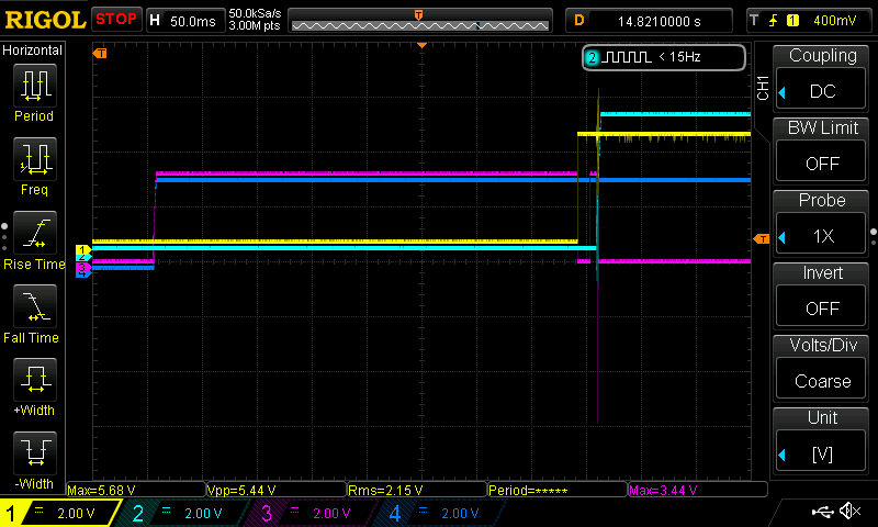

I send a two screenshot of oscilloscope.
At first is startup without destroy
(yellow-RESET,
light-blue - MUTE,
pink- FAULT
dark-blue - OTW.)

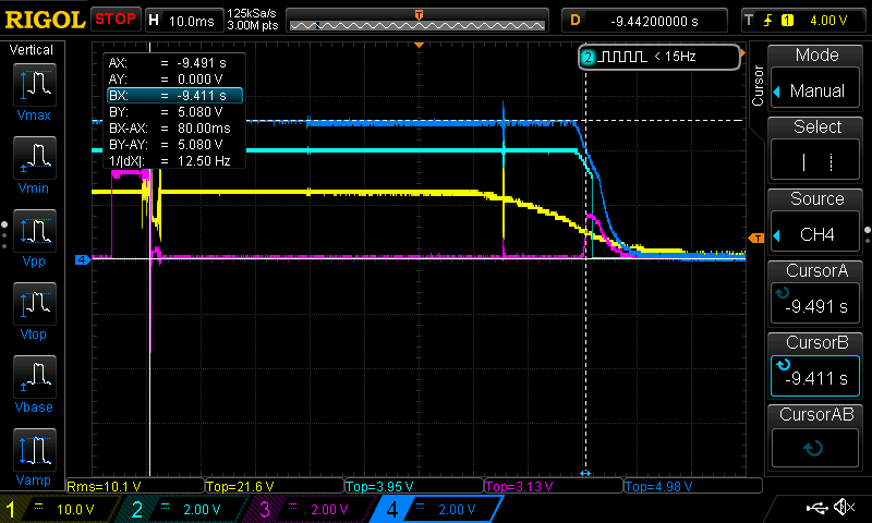

and second startup with destroy
(yellow-PVDD,
light-blue - RESET,
pink- FAULT
dark-blue -VDD.)

  • Michael,
    What is the PVDD you are using. i am looking at waveform 2, seems like the voltage is just 12V? is that correct?
    Dylan
    In the damaged power up waveform, it shows some glitch on the PVDD and then fault was pulled low. Have you checked what caused the glitches on the PVDD rail?
    Sam

    Input power terminals are goes on short-circuited (will cause destruction).
    Michael

  • Hi Michael,
    Could you help to measure the pin shorts of PVDD/OUTx to GND?
    The damage you shows looks like a EOS damage, which only happens in high voltage/current situation. But checking the waveforms, there is no such situation and everything looks smooth(although the power rail/signals are still abnormal, like you have the PVDD glitches).
    Can you make good supplies on PVDD/VDD/AVDD/GVDD, and then pull up the reset to see if the device will damage again? Let's just exclude the power supply impact.
    Thanks!
    Sam

  • Hi Michael,
    The schematic looks good.
    For the layout, PVDD decoupling MLCC caps should be placed on the same layer with the device, and be placed as close as possible to the PVDD/GND pins. This will have impact on the design robust level when outputting high power.
    But for your case, do you have any audio input when the damage happens? Looks like there is no output power, right?
    The PVDD fluctuation happens right after the C_mute ramp up. I guess it's the moment when the device starts switching. I would recommend to capture the waveform to see the behavior of PVDD, OUTx pin(any of the PWM output), BSTx pin(the corelated BST to the OUTx). Trigger should be set as the negative edge of PVDD voltage(may be normal value -2V) to capture the moment of PVDD collapse.
    BTW, please also make sure there is no soldering issue which may also cause the damage...
    Sam

    Before i destroy integrated circuit, i noticed a strange voltage peak. It´s a normal? In any case, the destruction occurred shortly after the supply voltage was connected. Can this destroy the integrated circuit?
    It's not bad soldering because I have already replaced 8 integrated circuits and I have 2 boards to test. In any case, the same defect.

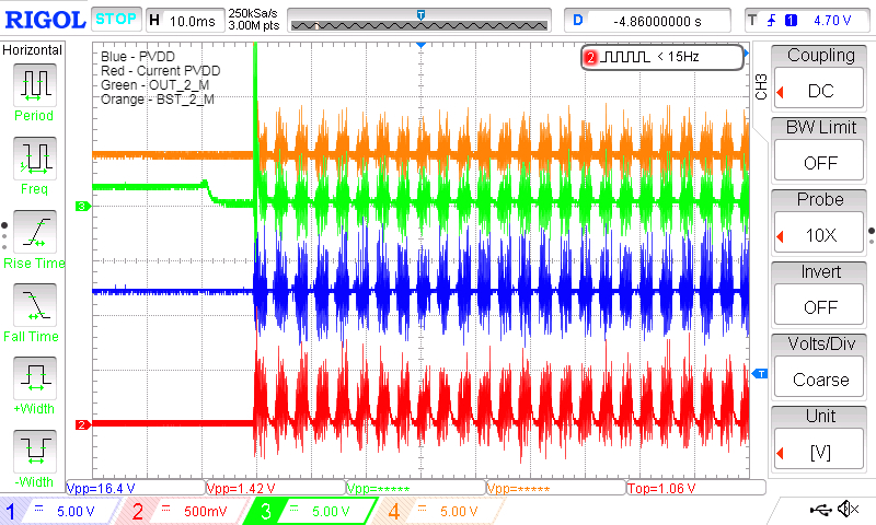

  • Hi Michael,
    It's not a normal behavior. The voltages had exceed the abx max range on datasheet. This may lead to damage. We need to find why there is such glitches rather than the PWM switching waveform in normal behavior.
    From the last waveform, I think the glitches show up when the device start to switching. Please zoom in the OUT_x waveform to see more detail. We need to figure out why it's not normal PWM waveform. In some cases, the insufficient power capability of the power supply could cause this kind of problem. Please check.
    Thanks!
    Sam

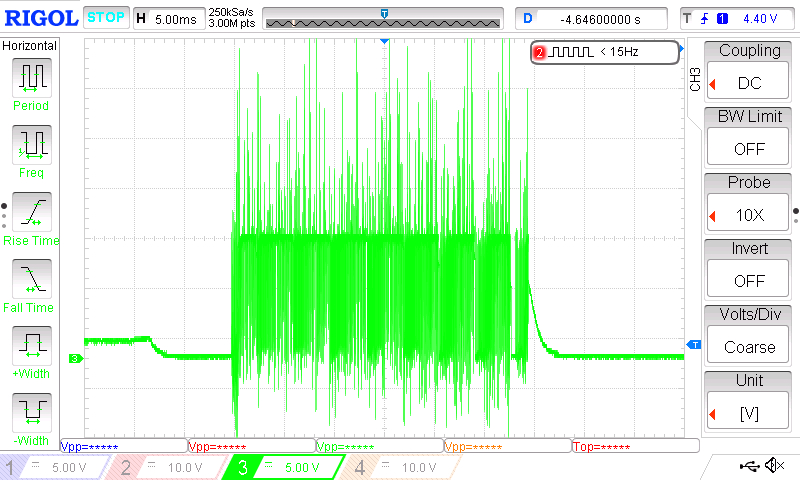

  • Hi Sam,
    fortunately I saved the wave record. yes, I also think that before destruction, the circuit will start to switch.
     i will try to add capacitors closer to tpa3221 (including mlcc capacitors).
    Michael

    The crosstalk among the channels is too high to identify much details from the waveform. The device is not damaged this time, it just didn't working well as expected, right?
    Looks like from some unknown reason, the CMUTE# pin is getting charged and discharged; and the abnormal behavior happens when the output ramps up to some level. Need to identify what happened at this moment. Please make sure the power supply has enough capability.
    You may remove the LC filter and measure the PWM output,(because the inductor in your design has limited rated current); capture the waveform on PWM output, at the moment the abnormal happens. The time scale should be in micro second range.
    Another point is, you are using head modulation in your design, coupled inductor may cause some issue here. If the PWM is normal without LC filter, could you change the inductor to non-coupling inductor?
    Sam

  • Hi Michael,
    CMUTE# pin can get charged and discharged when the RESET# is toggling. In the waveforms, glitches can be observed in multi signals. Is it fake glitches due to improper test setup, or it really exists?
    If AD modulation is used, then the coupled inductor connected in your current schematic will actually take no effect. This is because the AD modulation always have a differential current flowing through OUTP and OUTN. The current flow into the coupled inductor from dotted and undotted terminal, neutralizing the magnetic field.
    Looks like when there is no LC filter, everything is good. Even non-coupled inductor is used, which means the device takes some current, the problem happens, right? Usually this kind of is related to the power supply and layout.
    If you are designing a new board, please follow the EVM layout design as much as possible to lower the risk... And make sure the power supply is stably working .
