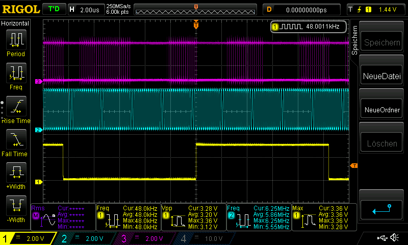

Actually I was hoping you could provide a screen shot of the 'broken data', along with the BCLK for reference.
Hi Tom,
thanks for your help so far!
I made some screen shots of the clock- and data lines.
This one shows a close up of the rising edge of LR&BCLK in "fail mode" purple is DATA OUT from the ADC:
This is the same after "shorting the clock" running normal:
This is 1FS of the fail state, again purple = DATA OUT:
Same for running normal:
Here a close up of LR/BCK
Hope this helps!
Florian
Hi Florian!
Thank you for the screen shots! Just to be sure that I understand correctly, in 'fail' mode, it looks like the SDOUT is stuck - repeating a pattern that is not valid data. Is that right, like the "1FS of the fail state" above - that output pattern continuously repeats?
Hi Tom,
The pattern is not 100% stuck, but some kind of similar over a period if time.
Hi Florian and Robin,
Thank you for the feedback! At this point, me and the rest of the team are still a little stumped here. The clock and data lines look pretty clean to me, so I'm less likely to point there. The BCLK frequency in the plots you sent over change a little, but that might just be your scope. What are the differences between this project and the others that have no issue with the PCM1840? Layout the same, but different software?
