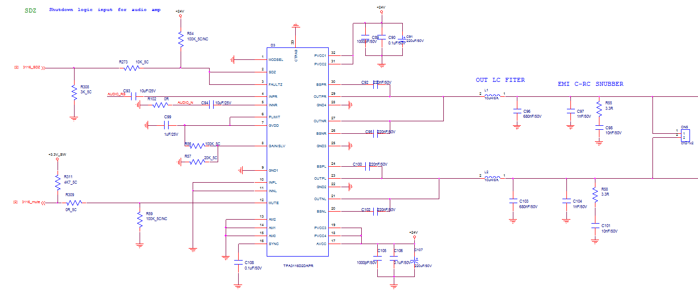

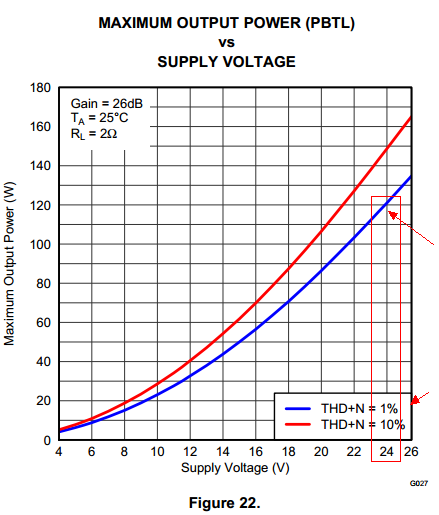

I use one TPA3116 amps in my circuit. In my circuit I use a single supply +24V.
In order to get 100W output power, I use the MONO MODE (PBTL) .
I changed a higher  Isat inductor (4.7uH,11A),and use a load of 2 ohm.
When the output power is high (for example, 100W), THD+N can not be stable and is slowly getting worse(0.6% to 5%).
How can I fix this problem ?
