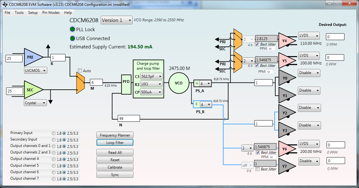

We are using CDCM6208 to generate below frequencies
1. 200MHz @ Y5
2. 200MHz @ Y6
3. 110MHz @ Y4
All are set as LVDS outputs. We feed 25MHz TCXO as the Primary Reference clock.

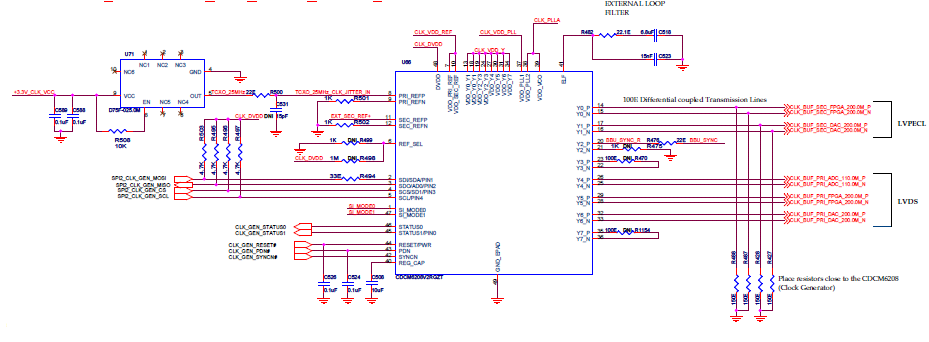

We have simulated for these frequencies in EVM software and we got the register values which are attached as text file with this post. With these values, in Simulation software, we are able to get accurate output frequencies. However when we load the registers on our custom board, the output frequencies are 116MHz @ Y4 and 208MHz @ Y5 & Y6.

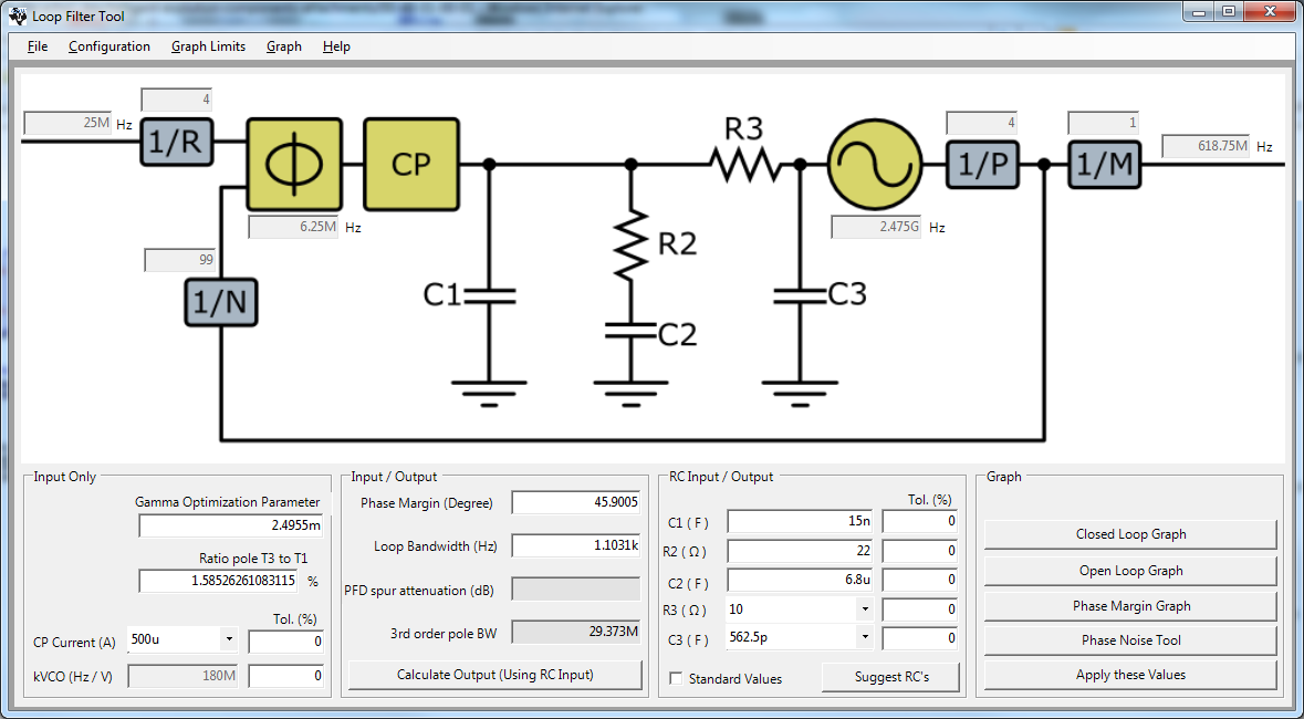

Why is this deviation? We have designed Loop Filter for 1KHz (The Schematics is attached with the post)

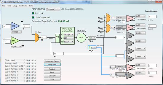

    Please confirm that the images below represent the configuration you are trying to achieve.
    The configuration looks OK. I assume the TCXO input to PRI_REF is a clean 3.3V signal
    The CDCM6208 LVDS and LVPECL outputs need to be AC coupled (and in some cases DC biased externally) into the receiver. The output type is really CML when configured as LVPECL / LVDS. The 150 ohm resistors on Y0 and Y1 should not be populated when configured for LVPECL. These outputs (if used) would need to be AC coupled and DC biased externally.
    One reason why the outputs could be incorrect on power-up is failed PLL calibration due to premature toggling of the Power Down Pin (PDN) before the supplies to the device are stabilized. Also, the reference clock should be available and stable when the device powers up. Try re-calibrating the PLL by toggling the RESET pin after a faulty power-up. The TCXO input should be available and stable before a re-calibration is initiated.
