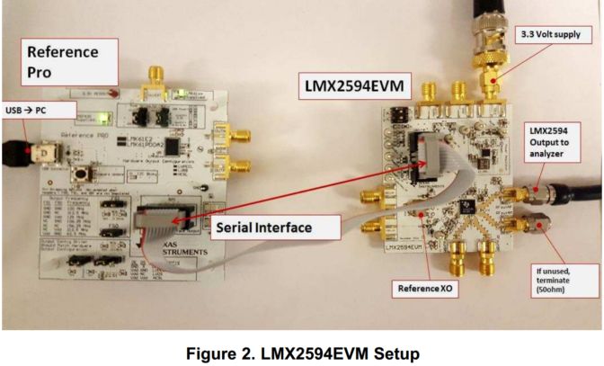

LMX2594EVM: Looking for Serial Interface board for LMX2594EVM.
Part Number: LMX2594EVM
Other Parts Discussed in Thread: LMX2594, LMK61E2, USB2ANY
Looks like LMX2594EVM needs to work with the board on the left side in the below figure, where I can find the model of the left board?
Many thanks.
BR
Kelly
  • Dear Kelly,
    The reference pro board is not for sale directly. You may get one of these if you order LMX2594.
    If you are interested in the feature of the reference clock, you may order the LMK61E2 EVM. You will get the same clock performance but fully programmable.
    www.ti.com/.../snau188b.pdf
    Robert Pulatie
  • Kelly,
    The LMX2594 can be programmed with the ReferencePro board (the one on the left side of the picture) or the USB2ANY board.
    We typically ship the ReferencePro board with the TICSPro board, but if you have a USB2ANY board this will work also.
    These boards are standard and work with all our LMX and LMK EVMs.
    The difference between teh ReferencePro board and TICSPro board (other than looking different) is that the ReferencePro board can supply an output signal.  However, the LMX2594 comes with an unboard XO (Vectron VC-708) which is lower noise than the reference Pro.  The USB2ANY board is a grey plastic enclosure and it says USB2ANY on it" grey plastic box with the same ribbon cable.
