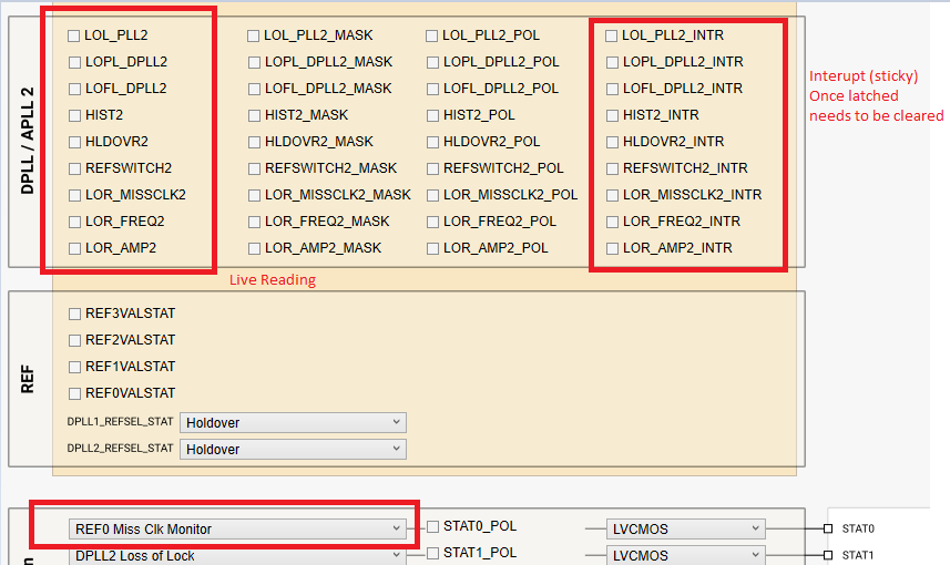

  • Hi Taka,
    All interrupt signals are available as live signals as well. That comment implies that the options/selections that are available, for example a DPLL LOFL or a REF0 MISS CLK, are the same. If you look in the GUI, you will see that the 2 columns have both.
    The GUI will also have the full list of what can be brought out onto status/GPIO channels (3rd box in the picture above, drop down menu). These will all be live readbacks. They will update to what current state is. They will not get latched and stay in a current condition as the interrupts do.
    If you connect a STAT0 output to an oscilloscope, and STAT0 is configured under REF0 MISS CLK, and you change the input frequency into REF0 you will see the signal go up and down, depending on whether missing clock gets triggered or not. So during the first trigger, it is showing you what the interrupt flag will be showing you, but unless you clear the interrupt, once you come back valid, the interrupt will remain latched while the live will show valid as will your output on the oscilloscope from STAT0.
    Regards, Amin

  • Hi Taka,
    What do you mean by "asserting flag"? Status 0 brought out is a live signal, it can produce a clock for example if configured to "PLL2 Ndiv / 2, div by 2", so I'm no sure I understand what you mean by "assert" and "de-assert".
    If it is configured to a REF0 MISS CLK - if missing clock is triggered (reference input is not valid) it will be high, once reference is valid again, it will be low.
    This is different from an interrupt signal. Interrupt signal once triggered, stays latched. You must issue a clear of interrupts before it goes away, irrelevant of whether the current signal would be high or low - (clock valid or not).
    If you're looking to capture whether for a given a time did anything trigger, then you have to readback the interrupts R19 and R20. Monitoring the output on STAT0 will only give information at that given time.
